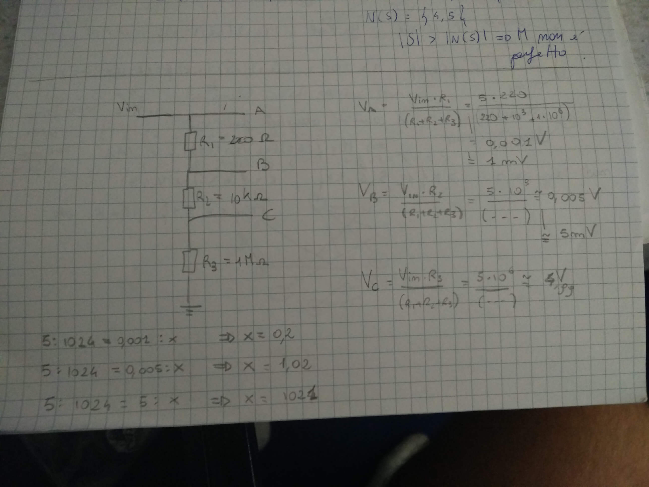

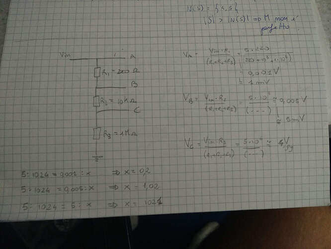

I tryed to attach the pic but it was too large, so I'm going to write the scheme.
Vin = 5V = V arduino;
Then, I've 3 resistence: A= 220ohm, B= 10kohm, C= 1Mohm.
So, applying the rules for a voltage divider, we obtain that the voltage on the resistence A is given by the formula:
V(A) = VinA/(A+B+C) = 5220/(220+10^3 + 10^6) = 0.001V = 1mV.
Repeating this for B and C we obtain that:
V(B) = 0.005V = 5mV
and
V(C) = 4.99V
Converting voltage to values of arduino we obtain that:
n(V(A)): 5:1024=0.001:n => n= 0.2 => n=0 (because of the numbers converted are INT);
n(V(B)): 5:1024=0.005:n => n= 1.02 => n=1 (" " " ");
n(V(C)): 5:1024=4.99:n => n=1021.9 => n=1021 ( " " " ");

Sorry but a waste of time. You are asking us to reconstruct your schematic from a wiring list. This is asking too much.
Just done. (See attachment)
Wrong (I'll check it tonight)
Try again using this and this as a guide.
Button 1 = 5V....... .= 1023 analog counts
2 = 4.892 V = 1000 analog counts
3 = 2.5 V ... = 511 analog counts
(3+4) = 0.5025 V = 514 analog counts
4 = 0.049 V = 10 analog counts
Button 3+4 is 10k in parallel with 1 Meg which results in 10k/(9900 +10 k) = 10k/19900 = 0.5025 V
As you can see, the difference between Button 3 and Button 3+4 = 2.5125628 V - 2.5 V = 0.010 V
which may be 4 analog counts which may sound the same as button 3.
The difference between 10k and 10k || 1 Meg = (10000-9900) = 100 ohms

If you are now using the ladder network then my calcs don't apply because they were done for your OP.
Your calculation for button C in your posted calculations should be: 4.9495 V
1 Meg/(10000+200 +1 Meg) = 0.9899 => 5V * 0.9899 = 4.9495 V
The others are wrong too but I don't have time to do those right now because I have to leave for work. I will say that your mistake is the denominator should be everything BELOW the resistor in question :
VB should be (R2 + R3)/((R2 + R3) +R1) =(1 Meg +10 k)/ ( (1 Meg + 10 k) + 200) = 0.9998 => 5V * 0.9998 = 4.99 V
NOT 5 mV
With what you posted last the voltage at A is always going to be the voltage at Vin. They are connected to the same point in the circuit so how could it be any different?
Remember the A/D in the Arduino is 10 bits, that means 1024 steps. With a 5V reference the steps are going to be 5/1024 V or 4.88mV.
The current down the chain is Vin / (1M + 10K + 200R ) = Vin/ 1010200 A or if Vin is 5V then the current is 4.96uA, lets call it 5uA.
So across the 200R resistor you will develop a voltage drop of 0.001V - about a fifth of a step from the A/D
Across the 10K you have 0.05V or about 10 steps.
