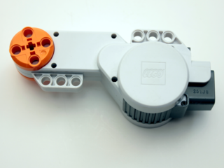

I'm trying to establish a PID control of Lego encoder motors (PID_v1) -
unfortunately I' don't manage to tune the P, I, D constants appropriately, satisfactorily.
I'm stuck to my best attempts by
double aggrKp= 0.6 , aggrKi= 90 , aggrKd= 0.1 ;
double consKp= 0.5 , consKi= 80 , consKd= 0.05 ;
#define PID_REGTIME_MS 3
#define PID_REG_PREC 5
double PID_REGMAX = +150.0;
double PID_REGMIN = -150.0;
but the motors still overshooting and partially jerking or strongly oscillating.
I know that there is a autotune lib, but my Arduino skills are too low and my English is too poor to understand how to use that, regrettably.
Has anybody managed to find better tuning values?

A set of PID control parameters is always optimised for a particular load so you need to apply the system load before you attempt tuning. Differential action is unlikely to be needed for simple motor control strategy as the response time of a motor to a change in load or set-point is usually very fast. Differential comes into its own in long time constant systems such as temperature control. If you are building a crane or a robotic arm, differential action will be of use to provide high rate corrective input until your load gets near set-point.
I'd suggest you remove all integral (and differential if being used) and increase gain (proportional) until you get oscillation starting, then reduce proportional until all oscillation stops. You should now find an error (offset) between desired set-point and actual position. Gradually increase integral action to eliminate this off-set. You may find oscillation starts again, if so gradually decrease proportional action.

First tune just P and D with I set to zero. Tune for maximum P that gives stable response
Then carefully experiment with I until you get fast enough convergence to the precise value
without oscillation (you increase D to combat oscillation if necessary). If there is random
fluctuations then that's the D term being too high.

It should always be possible to prevent overshoot if you are manually tuning. If best means no overshoot then
you haven't achieved the best tuning yet. You have to trade speed for overshoot - small amounts of overshoot
enable faster response.
PID tuning has in part to be experimental, unless you have a very detailed and accurate model of the electrical
and mechanical aspects of the system. Note that tuning depends on the load and if the load varies you will
have to compromise somewhere or use something more sophisticated than a simple PID controller.

YOU do not seem to understand
You have been advised twice that tuning parameters depends on (mechanical) load so parameters simply cannot be used "out-of-the-box" without giving consideration to the application.

PID control is about the SYSTEM. The complete and entire system. A system which you have not yet described. Which means the only advice anyone can possibly give you is general tuning advice. If you want better answer provide more details.
There is no such thing as "magic PID parameters" that allow you to ignore the load. There is no such thing as "magic PID parameters" that allow you to ignore the attributes of the motor. There is no such thing as "magic PID parameters" that allow you to ignore any part of the system.
Your stated goal is impossible to achieve. It is mathematically impossible. It is provably impossible.
From your brief description you are trying to build an adaptive controller. But that is a guess. I suggest, instead of obsessing about PID, you describe the GOAL instead of the method.
