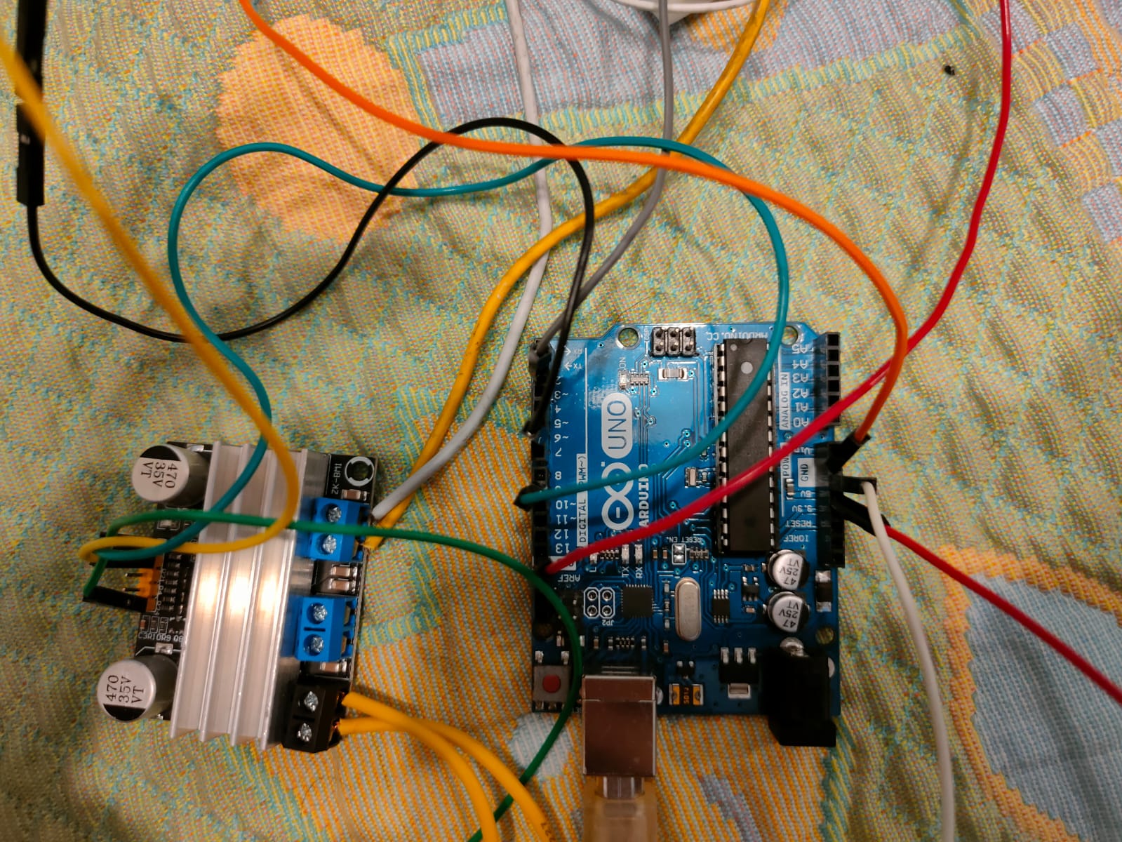

yes I'm sorry i forgot to mention, i'm using Zk-BM1 motor drive, it doesn't have pwm pins but it's IN pins supports pwm values, hence, i didn't use a pwm pin but instead i gave the pwm value to the used pins (maybe i'm not 100% right about it but it's working for the positive setpoints.

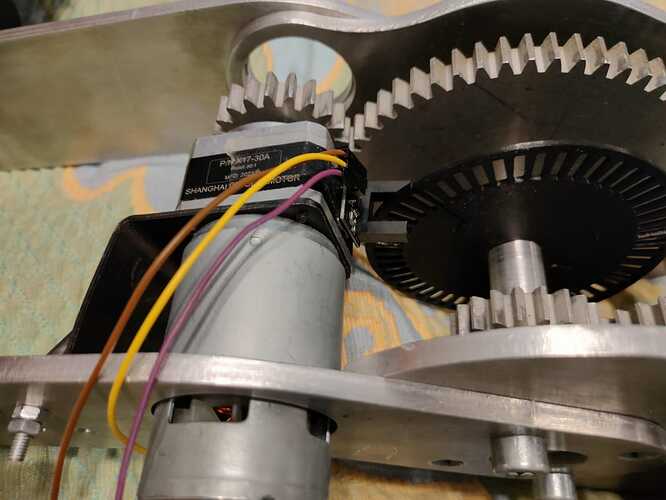

im using 755 dc motor along with H2010 encoder and ZK-BM1 motor driver
this is a picture of the wiring set for the arduino with the motor driver, i'm sorry it's nothing close to a formal picture.

-the motor IN pins are at 6 ,9
-the encoder pin is at 2

It looks like your encoder can’t really differentiate direction and just assumes that the shaft is spinning in the same direction as the set point.
It won’t be able to tell which way the shaft is actually spinning and won’t be able to tell if it has gone too far.
When it moves past -45 and the pid calls for positive motion, either way the encoder disk moves will cause the count to count downwards.
To end up at a target position, you need to accurately keep track of the motor shaft position during both directions of shaft rotation, and full control of both rotation directions will be needed, depending on the starting shaft position, and in the case of target overshoot.
To accomplish that, a quadrature (two channel) encoder is required to determine which direction the motor shaft is actually spinning, then count in the appropriate direction.

Hardware-solution-wise Can you fit a second sensor onto ther disc? If it is out of phase from the other sensor even a little bit it will give you a quadrature direction signal.
