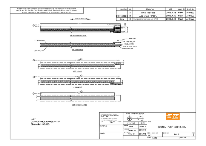

I have a piezoelectric ribbon sensor that I am trying to get to turn on an LED when a force is applied and a "knock" is detected. It seems to work every so often but not consistently. When I have the force values printed it is showing that it seems to be reading force values even when I am not touching the sensor. It'll start at the negative value of the baseline from calibration then steadily increase without any force applied. I am using a 1M ohm resistor for it. I'll post my code and setup below. Any help would be appreciated.

Don't use a LED without current limiting resistor.
You will burn pin13 the way you have connected it.
It seems you have the the resistor connected in series, which is wrong.
Please post a clearer picture of the breadboard.
An int can only hold 32 readings of 1023 before it overflows.
Leo..
This is how I originally had the board set up and it was doing the same things. I have a 330 ohm resistor on the LED
I have used this example exactly and I'm not getting the same results. I am using a piezoelectric ribbon sensor which is a bit different from the discs, so I don't know if that changes things.

I think I still see the resistor in series with the piezo, which is wrong.
The 1Meg resistor goes across the piezo.
So resistor connected to A0 and ground,
and piezo also connected to pin and ground.
Leo..
This code worked but it turns the LED on when I kind of pull the sensor rather than just when I touch it. I don't know if there is a way to fix that. Thanks!
try threshold 10
