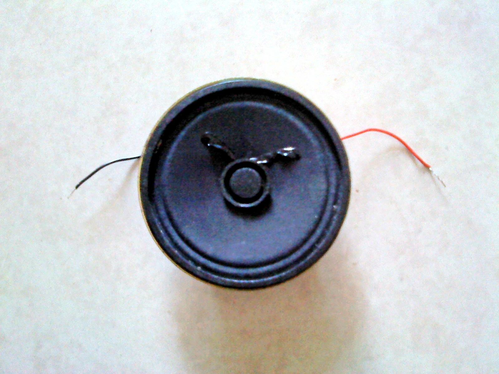

I have an arduino atmega8 and i tried the 'melody' tutorial but the 8 ohms speaker is only playing the c note in different octaves and no notes in the middle...please help! Is this a speaker problem or?

Are you sure you are using a 8 ohm speaker? You state it's a piezoelectric speaker and that may or may not be what you think it is. Some piezoelectric elements only respond to one specific frequency and are not able to reproduce a range of audio frequencies. So do you have link to what you specifically are using?

Did you get Lefty's point piezoelectric speakers are not 8 ohms, so what do you have. A photo would be good if you don't know.
Its a 5W, 8ohms speaker.
Yep it is. How are you connecting it up?
Direct connection to an arduino pin will overload it and damage the arduino.
You need to connect the pin to an amplifier or at least a transistor driver. The limit on the pins is 40mA, ohms law sows this will draw 625mA that is almost 16 times the threshold for damage.
Abhishekwalimbe:
Ok that will work fine. However it's NOT a piezoelectric speaker, it's called a dynamic loudspeaker ( Loudspeaker - Wikipedia ). Also because it has a 8 ohm voice coil it's very possible you will damage the arduino output pin because the speaker will attempt to draw too much current from the pin. I would recommend wiring a 150 ohm resistor between the output pin and one pin of the speaker, the other speaker terminal would then wire to ground. The volumn may well then be too little for you use, but at least you won't damage your arduino. External audio amplifier would be the only way to increase the volumn if required.

I didnt know the threshold for the current through the pins. I didnt connent the resistor because the volume was very low. Now how do I know if the pin is damaged? Will it completely stop working? and is it beyond repairs?
It is because you overloaded it.
Yes but probably not immediately, it's life will have been shortened.
Yes
Unless you count replacing the processor chip as a repair.
