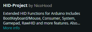

bonjour a toutes et tous , bon avancement du petit projet changement d un arduino plus adapté (leonardo) un croquis qui correspond a ma demande mais j ai toute fois un message d erreur et je ne sais pas quoi faire
(C:\Users\ludor\AppData\Local\Temp.arduinoIDE-unsaved202553-7940-9dqo4s.0tlf9\sketch_jun3a\sketch_jun3a.ino:1:10: fatal error: HID-Project.h: No such file or directory
#include <HID-Project.h>
compilation terminated.
exit status 1
Compilation error: HID-Project.h: No such file or directory)
si quelqu'un est en mesure de m'aider je prend merci d avance
Bonjour ludo24
As tu installé la bibliothèque HID-Project.h:
Cordialement
jpbbricole
je regarde ca desuite mais je crois pas
oh la c'est pire tout est en defaut du coup avec l ajout

voici ce que donne le dernier message d erreur
In file included from c:\users\ludor\documents\arduino\libraries\hid-project\src\hid-apis\KeyboardAPI.h:29:0,
from c:\users\ludor\documents\arduino\libraries\hid-project\src\hid-apis\defaultkeyboardapi.h:27,
from c:\Users\ludor\Documents\Arduino\libraries\HID-Project\src/SingleReport/BootKeyboard.h:30,
from c:\Users\ludor\Documents\Arduino\libraries\HID-Project\src/HID-Project.h:50,
from C:\Users\ludor\Documents\Arduino\sketch_jun3a\sketch_jun3a.ino:1:
c:\users\ludor\documents\arduino\libraries\hid-project\src\keyboardlayouts\improvedkeylayouts.h:54:21: note: #pragma message: Using default ASCII layout for keyboard modules
#pragma message "Using default ASCII layout for keyboard modules"
In file included from C:\Users\ludor\Documents\Arduino\sketch_jun3a\sketch_jun3a.ino:3:0:
c:\Users\ludor\Documents\Arduino\libraries\Keyboard\src/Keyboard.h:132:7: error: redefinition of 'class Keyboard_'
class Keyboard_ : public Print
In file included from c:\Users\ludor\Documents\Arduino\libraries\HID-Project\src/HID-Project.h:51:0,
c:\Users\ludor\Documents\Arduino\libraries\HID-Project\src/MultiReport/ImprovedKeyboard.h:33:7: note: previous definition of 'class Keyboard_'
class Keyboard_ : public DefaultKeyboardAPI
C:\Users\ludor\Documents\Arduino\sketch_jun3a\sketch_jun3a.ino: In function 'void loop()':
C:\Users\ludor\Documents\Arduino\sketch_jun3a\sketch_jun3a.ino:38:17: error: 'attente' was not declared in this scope
delay(100); attente 100 milisecondes
C:\Users\ludor\Documents\Arduino\sketch_jun3a\sketch_jun3a.ino:43:25: error: expected ';' before numeric constant
C:\Users\ludor\Documents\Arduino\sketch_jun3a\sketch_jun3a.ino:50:25: error: expected ';' before numeric constant
Plusieurs bibliothèque trouvées pour "Keyboard.h"
Utilisé: C:\Users\ludor\Documents\Arduino\libraries\Keyboard
Non utilisé: C:\Users\ludor\AppData\Local\Arduino15\libraries\Keyboard
exit status 1
Compilation error: 'attente' was not declared in this scope
Remplace:
Par:
delay(100); // attente 100 milisecondes
Si toujours pas bon, mets ton programme en ligne.
