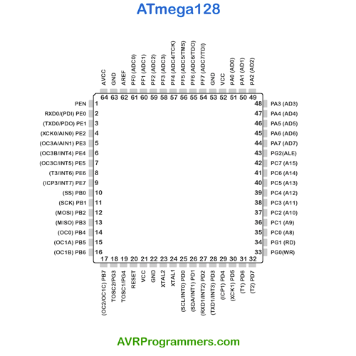

I am trying to make pins_arduino.h file for atmega varient atmega 128, but failing to do so. My purpose of doing it is so that i can use Arduino as programmer.
I have searched web for exact files but no one seems to have made it. With out that file programming Atmega 128 is seeming not possible.
I am too much frustrated as there is no guidance I can find to create such files.
Please help me.
Thank you in Advance.

Really? Nobody's written a core for that yet? Check other ones in that series (atmel typically makes a few chips in a series that are pin compatible, but have different amounts of memory)
Pins_arduino.h is the file with all (well, most of) the chip-specific stuff - it's where you define which pin number goes to which port, which timer is on which port, etcetera.
AFAIK there's no documentation for it. I've always taken an existing one and modified it, and judging by code I've seen around, that's what everyone else does.
I would give some thought to the 1284 - it has fewer pins, which might sink it for your purposes, but it's otherwise a much more attractive chip, and lots of people on here do stuff with it. Unlike the atmega128.

Look at the file for a 2560 then - take out the ports that the 128 does not have. Ask more questions.
I am doing a comparison.... I am hoping to get this right. I will upload it here. If I make mistakes please correct the coding.
Please check the code, please help me rectify if there are problems. Thank you.
