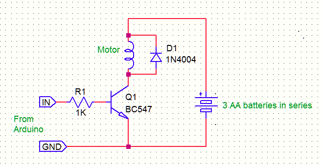

In the following code, the main goal is for the Vibration Motor to vibrate when the PIR Sensor detects movement. However, it seems like the PIR Sensor is not capturing any kind of movement. In other moments, the vibration motor vibrates in all moments. Even when the PIR Sensor is not capturing movement. I don't know if the issue is the coding or, the physical model.
PHYSICAL CONSTRUCTION
ARDUINO + SENSOR
VCC → 5V
OUT → D2
GND → GND
ARDUINO + MOTOR
RED → GND
BLUE → D3
CODE BEING USED

Information about the sensor and vibration motor:
PIR SENSOR: HC-SR501 PIR Sensor --> (https://produto.mercadolivre.com.br/MLB-1343109528-modulo-sensor-de-presenca-hc-sr501-pir-arduino-e-raspberry-_JM#position=7&search_layout=grid&type=item&tracking_id=83e07d3d-8873-442b-b49e-114d1fe77832)
VIBRATION MOTOR: Motor 1027 for Arduíno ( Nfe ) --> (https://produto.mercadolivre.com.br/MLB-2924479634-motor-de-vibraco-1027-para-arduino-nfe--_JM#position=27&search_layout=grid&type=item&tracking_id=385241eb-d22f-48c1-92fb-e0b73f8f50b8)
Never connect a motor directly to an Arduino pin it can damage your Arduino.
Don't post images of code, use code tags <code>
Provide a link to or data sheet for the motor and PIR sensor you are using
Thank you! How could I connect the motor then?

Connect the motor like this using a transistor and 3 AA batteries
