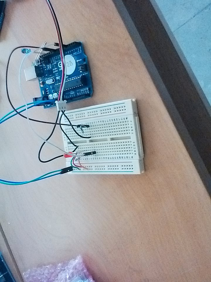

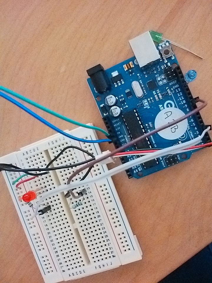

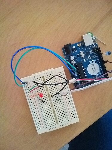

I feel like my circuit might be wrong,
. I've tried only the PIR sensor and the signal seemed to be working, /
I cannot make out what is connected to what in the pictures.
Make a CLEAR circuit drawing on a sheet of paper and then take a CLEAR IN FOCUS picture. Attach to a post.
