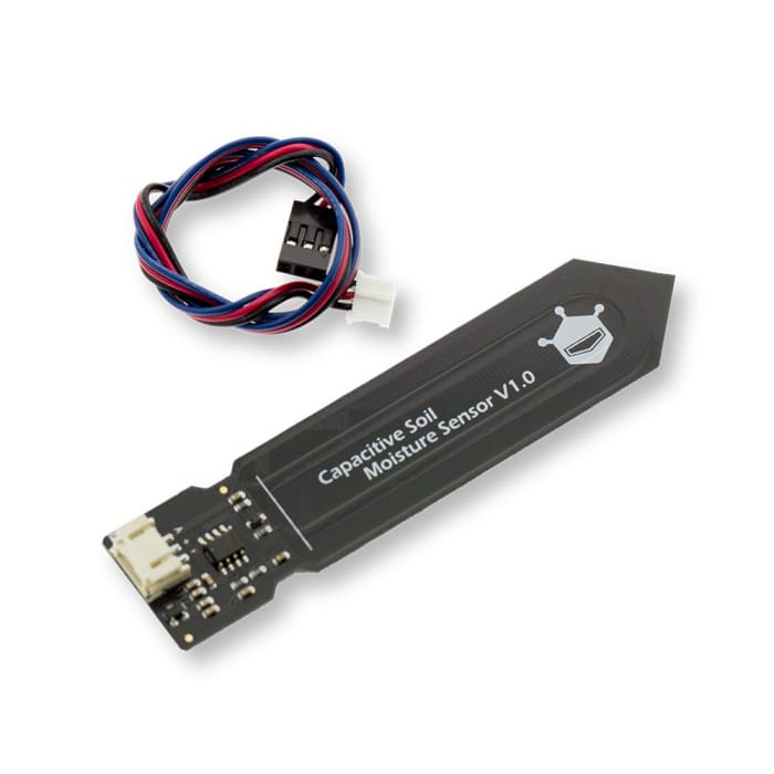

I recommend a capacitive soil moisture sensor, the type you have in the picture will erode. Capacitive sensor doesn't come in direct contact with the soil, that's the trick.
