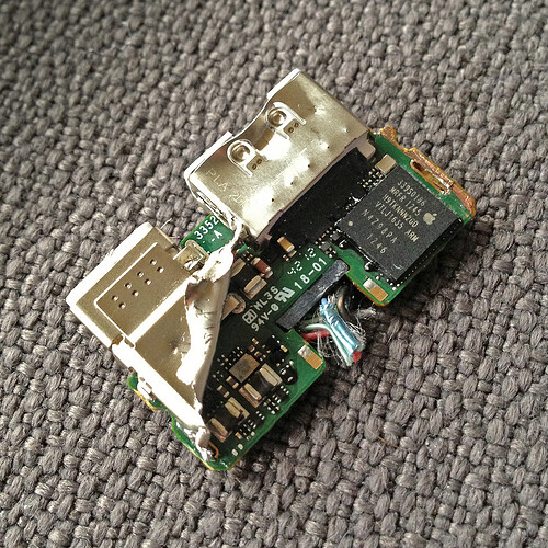

Apple' s own Lightning to 30-pin adapter recover UART pins? Some Apple Lightning Adapter has a SoC CPU, the member here who has X-ray machine might be able to help confirm if it is the case.

And now, it’s pure software issue. The Lightning is pure high-speed digital serial interface; all the controls regarding to the port configuration are encapsulated in API calls, and the functions of the ports can be electrically wired to different logic blocks of the main board with software controlled multiplexer, in semi-conductor level. And that means the serial interface is not even necessarily running USB protocol: it can be UART, I2C, or DMA. This concept is nothing new. In microcontroller-based application design we called it “USCI”, the Universal Serial Communication Interface. It’s a common approach to provide flexibility in circuit design when the package and pin-outs are limited.
In short, the pins in 30-pin connector are fixed function, and Apple have to control both hardware and software of a peripheral. But the pins in Lightning are flexible. The I/O ports are be configured to be dominated by user application, or physically wired to different logic blocks within the system, and Apple can achieve the same level of control with software only. I won’t call it “innovation” of other BS, but it’s a compromise design in favor of engineering.
