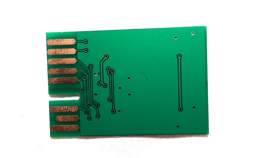

The picture of the hacking page shows another chip below the memory part. The control lines from the edge connector to go to that, then that device connectst to the memory part.
If we can determine what that part is you can probably get by with a simpler solution, likely serial read/writes, and that part acts as shift register/memory to capture the address & data to be written, or buffers the data read back to be read out serially.

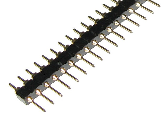

If not, then another option is to attach 18 wires and bring those to a connector such as this
that you can than plug into a breadboard, and add your own 5v to 3.3v level converters.
Then you can connect to 8 I/O lines from your arduino and 8 control/status lines and power/gnd, and remove the magic gate part and the other part and contol the memory part directly.

If you can post high resolution, clear, pictures of both sides of the card, we can see if using the onboard buffer would be possible.
