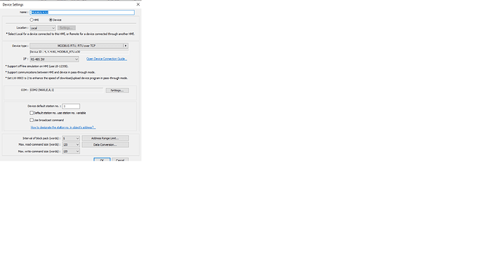

Hi, i,am trying days and days to connect my HMI MT8071IP Weintek to a arduino, i want to control some leds and reles by the hmi, i have one module RS485, but always and always say "Device or clp no response", if anyone did it, or know how to do it please help me

As we have no idea of your wiring or your code, I suggest that you enlighten us about both.
A link to the hmi device might also be useful.
Please post you code, and a schematic of how you have hooked everything up.

I´m connecting RO - RX(0)
DI - TX(1)
DE AND RE - D2
A (PIN 2)
B (PIN 1)
I tryed to change pin A and B some times but doesnt work
That's not a wiring diagram. Way too much is missing.

Now, a clear photo, and a drawn diagram of how everything is wired together,showing power, pin numbers and ALL parts you are using.
