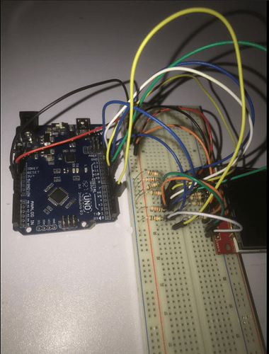

please help with 2.8 Spi display ili9341
I have two 2.4" boards like your one. One says T_DO and the other says T_OUT.
Your photo looks wrong to me. Perhaps this is a better diagram:

Edit. I have improved my diagram. Shows the columns better. To show where to insert wire links or resistors.
before I did try the Adafruit_ILI9341 library example "graphictest" with the wiring that posted before with the 1k resistors and it did work but it doesn't include the touch part wiring
I removed all the wires and reconnect again according to your last post.
With the new wiring the Adafruit_ILI9341 library example "graphictest" don't work.
(Note: it does upload but it doesn't show anything)

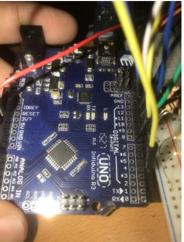

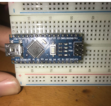

those are my arduinos
Only just looked at your PNG.
It seems to be Infiduino R3 which is switchable 3V / 5V
So life is good. Just switch to 3.3V and everything works beautifully.

the touch works on all of them but I can't see anything in the display it just a white screen.
I double-checked my wiring with the scheme that I sent you.
I am using a Seeeduino switched to 3.3V GPIO. Which should be the same as your Infiduino when you set the switch to 3.3V
I suggest that you print the wiring scheme on paper. Then check each coloured wire and tick them with a pencil.
You can't get a simpler wiring scheme. There is just one 33R to limit the LED current. And three links e.g. T_DIN to MOSI. T_OUT to MISO. T_CLK to SCK.
You can remove all four T_xxx connections. Then the Screen will be the only item on the SPI bus.
Note that jumper wires are not very reliable. Swap with good wires one at a time.
The RST pin must be under program control. The If the RST jumper wire is broken, the Screen will just show white.
