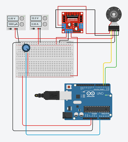

I am using an N20B DC motor with an encoder to measure speed, an L298N motor driver for control, and a potentiometer to adjust the motor speed.
I want to display the voltage and speed curves on the Serial Plotter. The speed will change by adjusting the voltage using a potentiometer, demonstrating a first-order system response. From these curves, I aim to derive the transfer function, such as Kτs+1\frac{K}{\tau s + 1}τs+1K​.
Additionally, I would like to know how to determine in the code the motor's encoder pulses per revolution (e.g., encoderPPR = 12) and set the measurement interval (e.g., interval = 100 ms).
I used the code below,

What did you expect to happen, and what happened instead?
Please post your code in line, using code tags (<code> post editor button).
" attachInterrupt(digitalPinToInterrupt(ENC_B), readEncoder, RISING);"
Pin 4 is NOT an external interrupt pin.
  • a conventional approach is to use a timer that captures a running count each time it expires and subtract the count from the previous count.
  • not sure if you need to handle contact bounce using a mechanical encoder. optical and hall effect encoders don't have bounce
  • not sure if you expect an x vs y plot which is not possible using the Serial plotter

i have replaced that with pin No. 3
Is your motor a gearmotor (with speed reducing gearbox attached)?
If so, do you have access to the back of the motor so it can be turned by hand?
Yes, it's same as in this link (6V, 105 R.P.M)
Also, it can be turned by hand from the side of encoder wheel but not from the shaft side
and if so, what is the point of that I didn't understand what you mean?
So you can turn the motor shaft 1 turn and see how many pulses you get.
