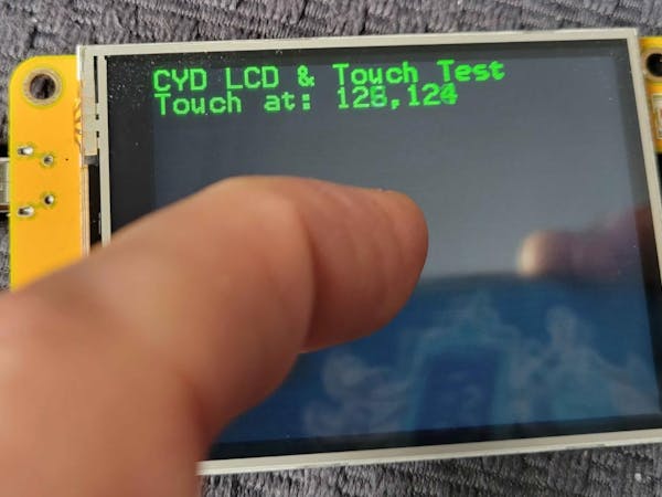

Yes is esp32
But what sort of esp32 there are lots of different types?
I have cyd esp32
So.. in my serial terminal, i see: 0Km 1m 124cm or 0Km 2m 224cm
But i cant find how to make: 0Km 1m 24cm
cm = cm-m*100
Do you mean this one?
