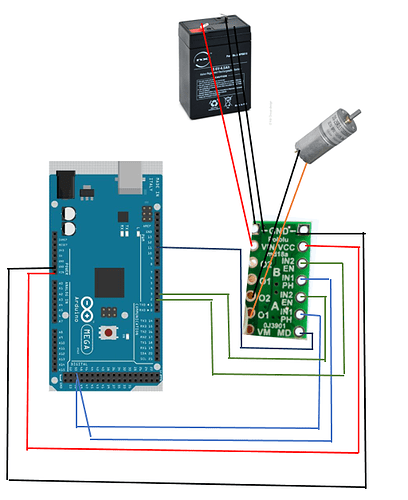

I need some help with my DRV8835 :
I need to connect 2 DC motors with this h-bridge, but I can't found any working program, (I'm using the DRV8835MotorShield library).
The connections are :
MD -> +5V
IN1 PH A -> pin 51
IN2 EN A -> pin 3 (PWM)
IN1 PH B -> pin 50
IN2 EN B -> pin2(PWM)
VCC-> +5V
VIN-> +6V
GND -> pin (-) of the battery.

Can you please post a copy of your current circuit, in CAD or a picture of a hand drawn circuit in jpg, png?
Label the pins and make sure you include your power supplies.
A picture of your project would help with component layout too.
Thanks.. Tom.. :slight_smile:
Here you are .......
Thank you so much !!!! :slight_smile:
Thierry

The Fritzing picture shows VCC of the motor driver connected to V-in of the Mega. Should be VCC to the 5volt pin.
How is the Mega powered.
If you had >7.5volt on the DC jack, and the motor driver connected like that, then the driver could be toast.
Leo..
