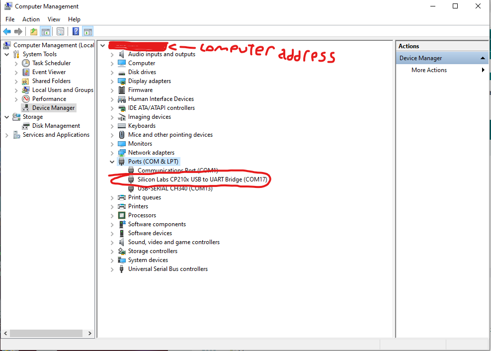

Port Error occuring on device manager and on Arduino IDE
I am trying to run a simple 'led blink' program using ESP32 and Arduino IDE, while setting it up I have used Silicon Labs CP210x driver (CP210x USB to UART Bridge VCP Drivers - Silicon Labs) as suggested in the hardware module. Initially my Windows system didn't detect it, so I manually added it.
dm_ports
It is giving this kind of error , so I tried to update it, uninstall & reinstall it again but nothing worked.

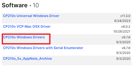

as for your problem:
did download the one highlighted in red?
Installing-CP210x-USB-to-UART-Bridge-Drivers-Windows-PC
Thanks for the guidelines. Yeah I downloaded the highlighted driver.

Can you suggest me which one i should opt for, as I have a windows system?
you already got the recommended version.
are you perhaps using windows 11?
if so the process might be different.
What's the process for windows 11? I actually tried using Windows 10.
for the windows 11 you might need the universal windows driver, as it's the newest windows driver.
I think it's made for windows 11.
Okay I will try that out with Windows 11.
Also will this Universal Windows driver work for Windows 10?
okay, I hope it works!
I used the windows driver for window 10, and never had a problem, I'm unsure as to why you're having issues.
Okay , thanks I will try with Windows 11.
the universal windows driver might work for windows 10, it's "universal", so you might want to try that one before you download windows 11.

it should look like this:
COM number doesn't matter.
please notify me if it doesn't work, so i can see what i can do.
