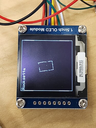

Weird I can't serial print vectors using the XIAO esp32S3 but they print fine on the OLED. So I guess I just start plotting points on the OLED which is what I wanted anyway.
OMG this is awesome. Thanks so much @jhaytera I was close to giving up. I can even zoom in
My code is here but might be labelled different when I am happy with it
That's awesome! You're welcome. That little display is cool.
Yes. It is a fast 16 bit grayscale 128 x 128 $13 USD oled from waveshare and the Portenta camera is Grayscale anyway.

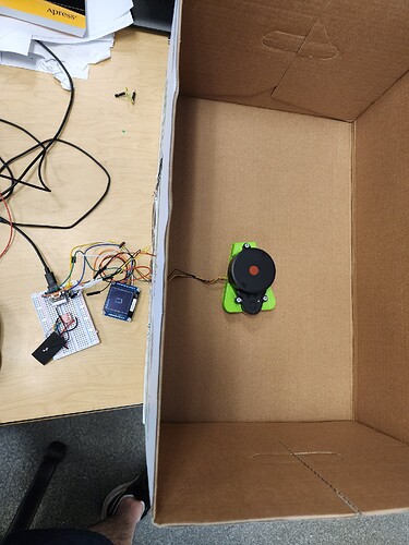

I made a few improvements. I still want to get it working on the portenta
Here it is inside this box

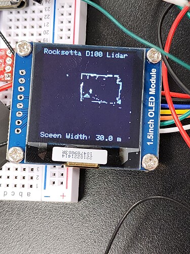

With a screen width of about 1 m it gets great resolution. Objects about 3 inches from the device show up. Any closer and they disappear.
With a screen width of 30 m I can scan my entire classroom, which looks reasonably accurate including the top right alcove which has a window. My classroom is about 14 m wide which also looks good. The device is near an open door in the bottom left of the classroom.
I can set the refresh time here at about 8 seconds but a first scan is fairly accurate after about 1 second.

What the pictures don't show is the time frame to come up with the diagrams. I have my code set for about 8 seconds per refresh, but the main diagram shows up in under a second. I can't wait to put this thing on a toy car and see if it works fast enough to help with the steering.
