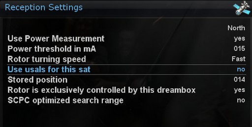

In the receiver interface positions are stores as in the attached screenshot (position #14). And there is another picture (in the garage) to show receiver (it has 4 tuners inside) and several positioners (numbered 1-6).

To control devices over coax cable Diseqc protocol is used . Some info is here Simple DiSEqC monitor and signal analyzer · One Transistor (but still looking.)

Very good first reference, that tells me exactly what I need to know for the electrical specification, and even mentions a protocol specification that should have info on how commands are encoded into the data.
This is possible because the protocol is modulated over a 22 kHz carrier.
DiSEqC protocol encodes bits as follows:
1 ms of 22 kHz burst followed by 0.5 ms pause means bit 0;
0.5 ms of 22 kHz burst followed by 1 ms pause means bit 1.
A byte is sent using 9 bits (first 8 make the actual byte and the last is the parity bit). If you want to know more, see protocol specification at Eutelsat web site.
It even shows you the filter you'll need to make in order to isolate the DiSEqC band from the satellite signal.
I'll try and dig a tone decoder out of my parts bin and experiment with it. It should be perfect for turning the 22 kHz pulses into a digital signal that the Arduino can process. It looks like it has some features in common with the NEC standard for IR remotes, so maybe I can steal some pieces from that.
