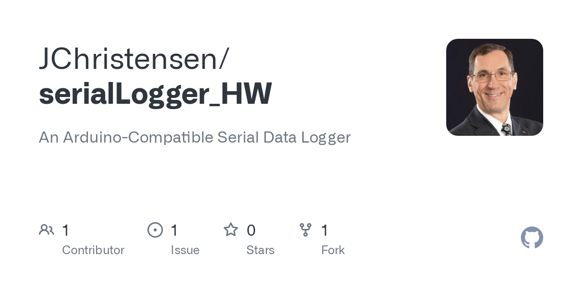

See Jack Christensen’s Serial Data Logger project that writes to an SD card.
