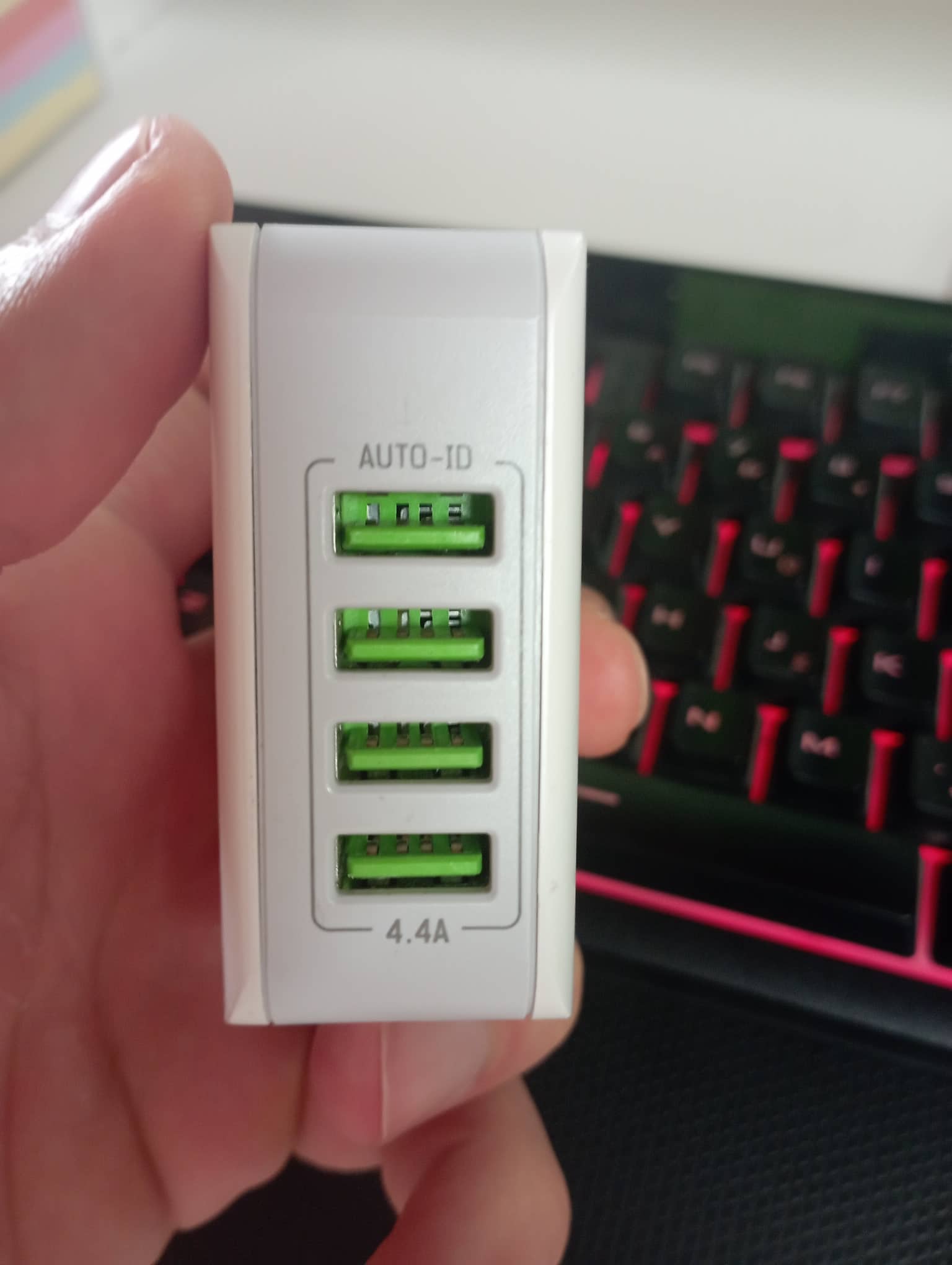

Can i power them using a classic 5V DC Adapter (like the one for smartphone charging) which can produce up to 4.4 Amps?

The adapter i will use is this one

NEVER ok to power a motor from ANY Arduino pin. Why not power ALL the motors from a suitable single power supply? Be sure to use wire sizes that can handle the current and solder the connections, except where screw terminals are provided.
No and use of a breadboard will fail with the currents you are using.
That could power one MG996R. For 4 of them, you will need a power supply capable of delivering more than 10 Amps.
Can the classic jumper cables for Arduino handle the current right?
No. Solder power connections and use a servo power distribution PCB.
