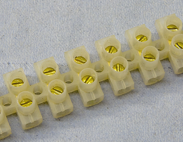

What do I need to directly connect the 4 x 2 wires to the adapter?
A soldering iron and some solder, perhaps?
Or maybe just some chocolate-block connectors?
...R
Since those servos have a stall current of around 2.5A each your 3A power supply might have hard time supplying 4 of them. And you definitely need good wiring direct to the servos NOT through the Arduino and not through a breadboard either.
