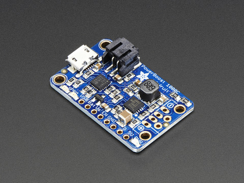

Should I get some kind of powerboost? Is the adafruit powerboost something I could use for upping the supply to 5V and for charging?

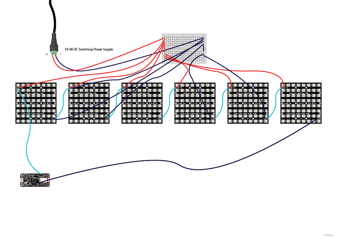

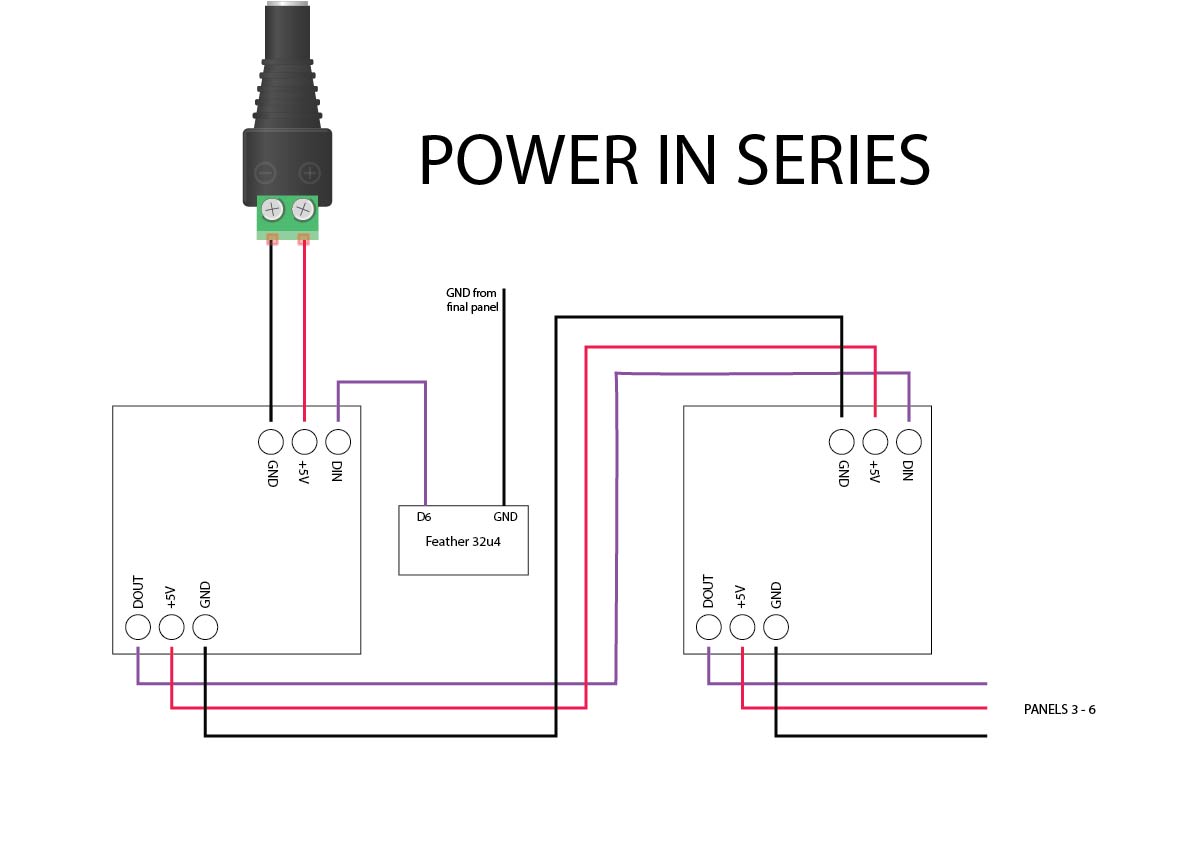

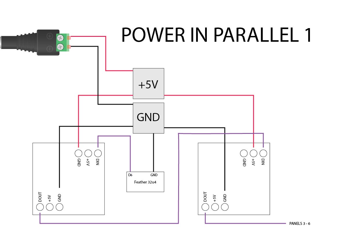

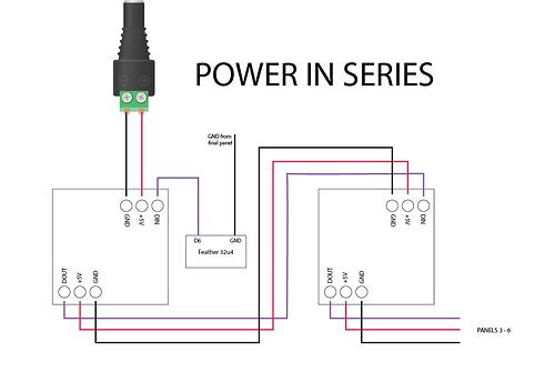

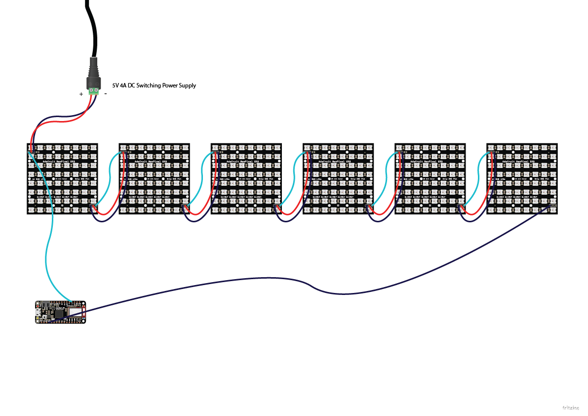

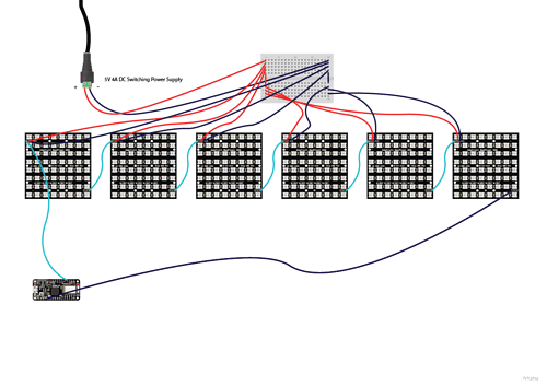

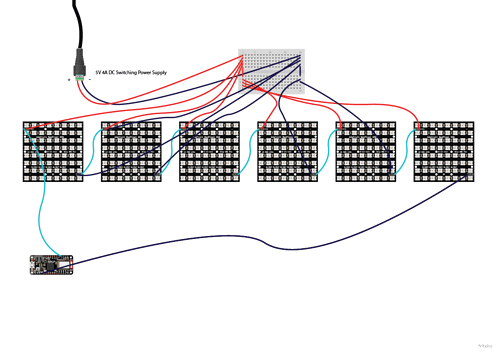

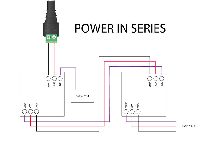

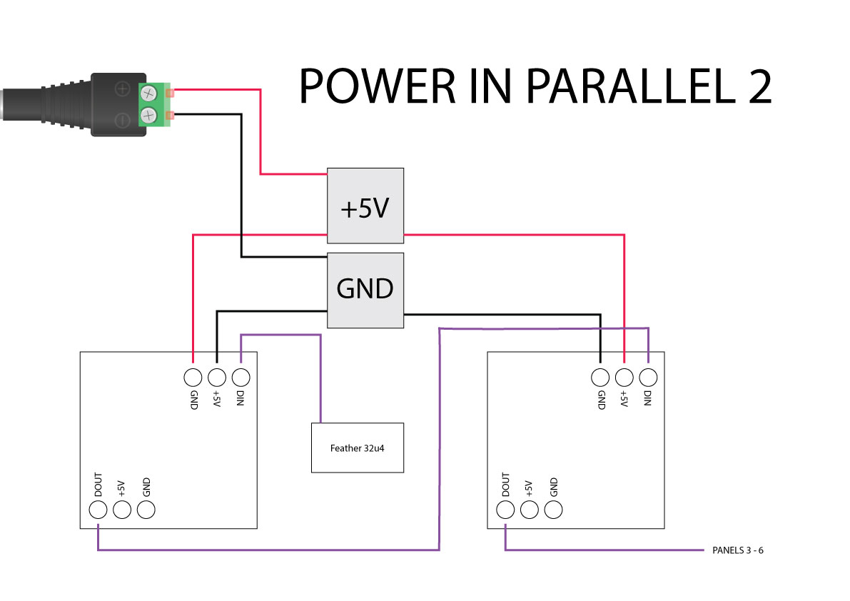

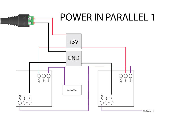

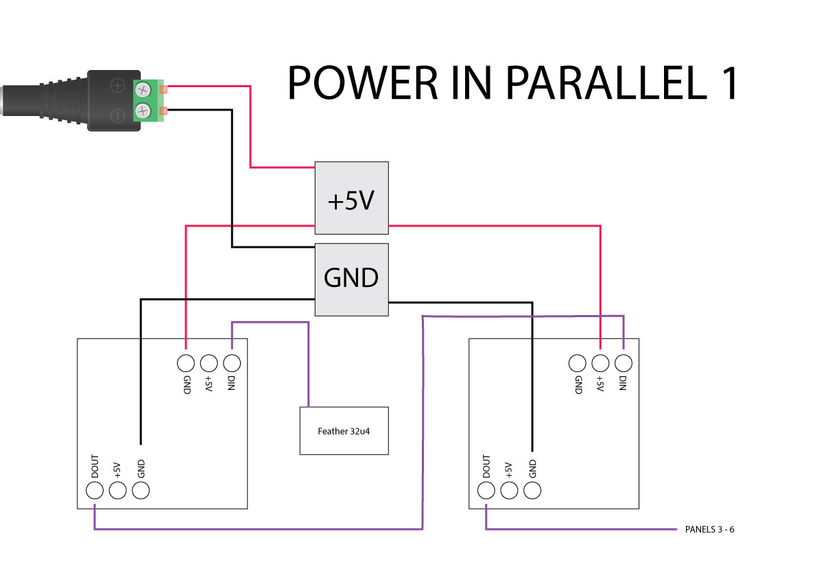

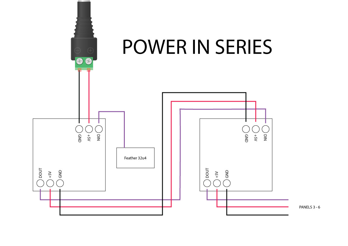

Regarding power - can anyone tell me what the best way to wire for power with the six panels?
I've tried power in series - running from one panel to another, and I've tried parallel, where I've broken pout the (+) and (-) to a mini breadboard, and then to the pins on each panel.
I get a problem where some of the panels are brighter than others - can anyone advise? See images for the three ways I think it might be wired up, but please tell me if I'm wrong!
Simplified diagrams...
Anyone have any advice?

OK, whatever. I got it working for anyone who's interested, using the Serial Option Two. I've also added a soldered perf-board power strip, making the power distribution FAR better, so now there is no flickering, and all the panels are showing exactly the same colour, where before there were very noticeable differences.
Here are some images, and yeah thanks for the help.
and a video of the thing with some frosted plexiglass housing. Looks sweet, and running at 5v 10 amps it's super-bright. I don't run it that high for more than a minute, as the whole device gets quite hot, so I set brightness to around 50 (out of 255) for normal running, and it's lovely.
