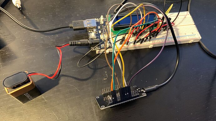

Hi guys how are you? Trying to understand what is wrong here if you can help I appreciate. So this is a ES8266 in a breadboard with external power supply. I am trying to power all this from 9V battery. The LCD turns on however seems the arduino is not working properly.
When I connect the arduino to my PC USB everything else works well, however if I disconnect and connect into the USB port that is powered by the battery, the arduino does not work. (LCD still turns on but no data come through).
Does that mean 9V battery cannot supply enough power to my project? Thanks.
Have you tried connecting it with any adapter connected to external power supply. If it works then probably you'll be needing a battery with more power supply.
Oh nice catch ! I just tried with it connected to the power supply on my wall and still DIDN'T work !! That is so confusing ! When I connect the USB to computer it works immediately!

Take a DMM and trace the power supply on the PCB of the Arduino.

I made it work. The thing is I had to connect an extra cable from 3V pin in the arduino to the breadboard "+" signal, so now all working thanks guys !
