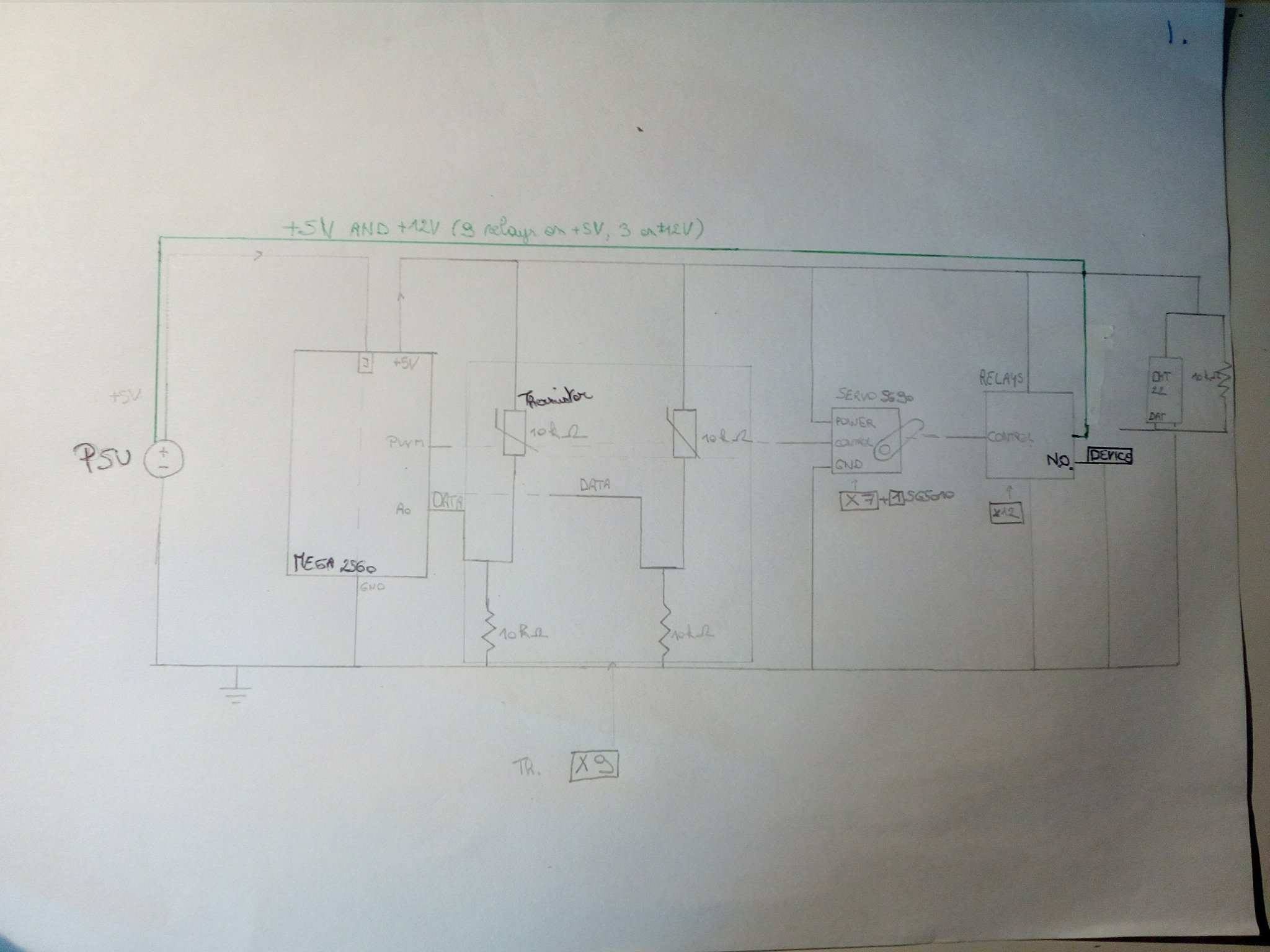

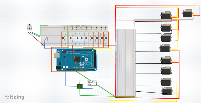

I put a simplified schematics of the circuit in attachment (fritzing made). I'm not using breadboards, I'm using Eurocard full lign pattern, and there are 12 relays, not just one.

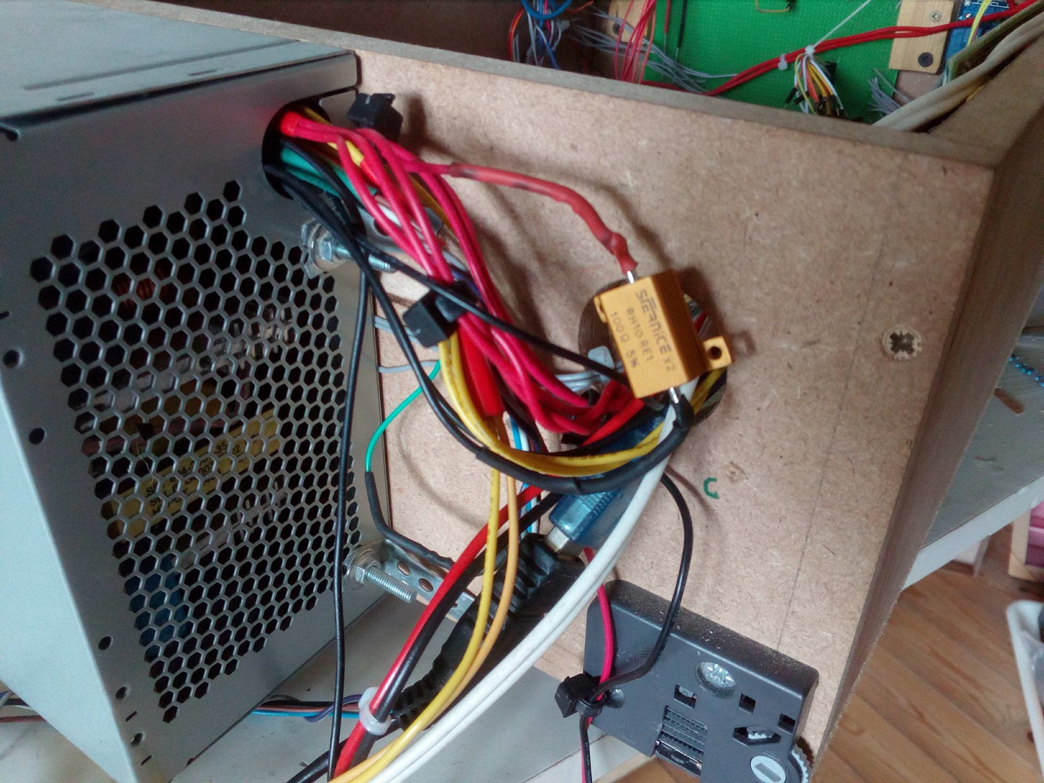

I'm using a red wire of the PSU to supply power to the Arduino (5V and up to 20 A), and it is connected to the jack plug. Should I use a "12V wire" ? (Altough it worked with 5V in a previous version of the project)
avr_fred:
Some older computer power supplies must have a minimum load on one or more outputs to maintain output voltage. The typical load is a 10 ohm, 10 watt resistor from VCC/+5V to GND.
I already put a power resistor, 10 W (connected to a red wire as well), to keep the PSU on. (Indeed, without it, the PSU stopped functionning after half a second, but the problem isn't the same here. The PSU runs normally, the power resistor heats and the LEDs on the Arduino are on, until I connect the circuit's Gnd and Vcc to the arduino)
That Fritzing is not at all helpful since it shows breadboards and many servos...you haven't mentioned servos before and what is the second breadboard that looks like it contains just resistors and capacitors? And what is a Wire 514? And where is the power supply?
Anyway if you are using 5V from the PSU it should not be connected to the Arduino jack plug. The minimum voltage for that is 6V and 7V+ is better.
It would also make a lot more sense if your circuit was connected directly to the 5V power supply rather trying to run all that current for your sensors and servos (or whatever they are) through the Arduino. That is a really bad idea.

Based on the Fritzing, I would not recommend powering anything up until you post a real schematic, hand drawn is fine and perhaps a photo of the bits and pieces you have. I have no idea of what that thing is in the Fritzing marked Wire 514.
As mentioned, you cannot power the servos using the +5 supply regulator of the Mega. Connecting the +12V supply to the barrel jack will let the smoke out due to the current requirements of the servos.
Sorry if the fritzing is useless, I will draw a more complete draft asap.
The "wire 514" stands for the relays.

Can you post a picture of you project please?
Thanks.. Tom.. :slight_smile:

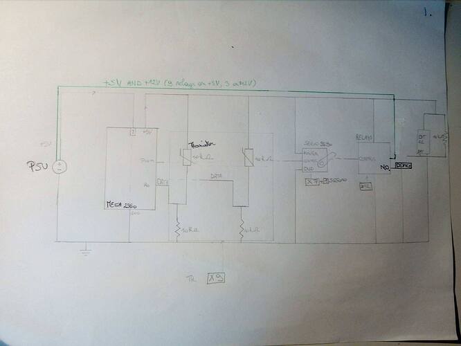

There is the hand draft of the "present situation" (with the arduino still powered in 5V through the barrel jack, and the hole circuit powered by the arduino and not directly by the PSU). I hope this one will be more usefull. :grin:

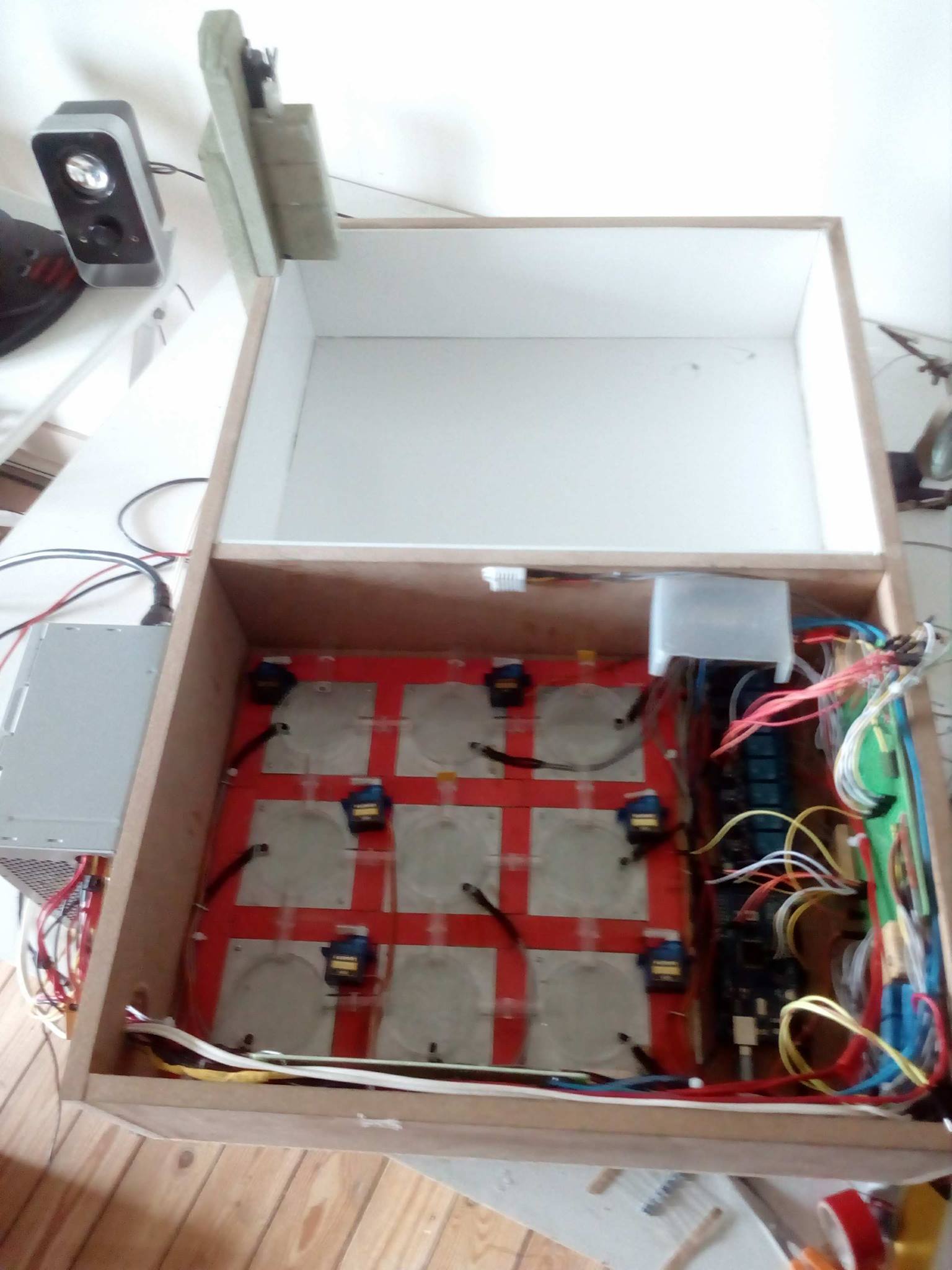

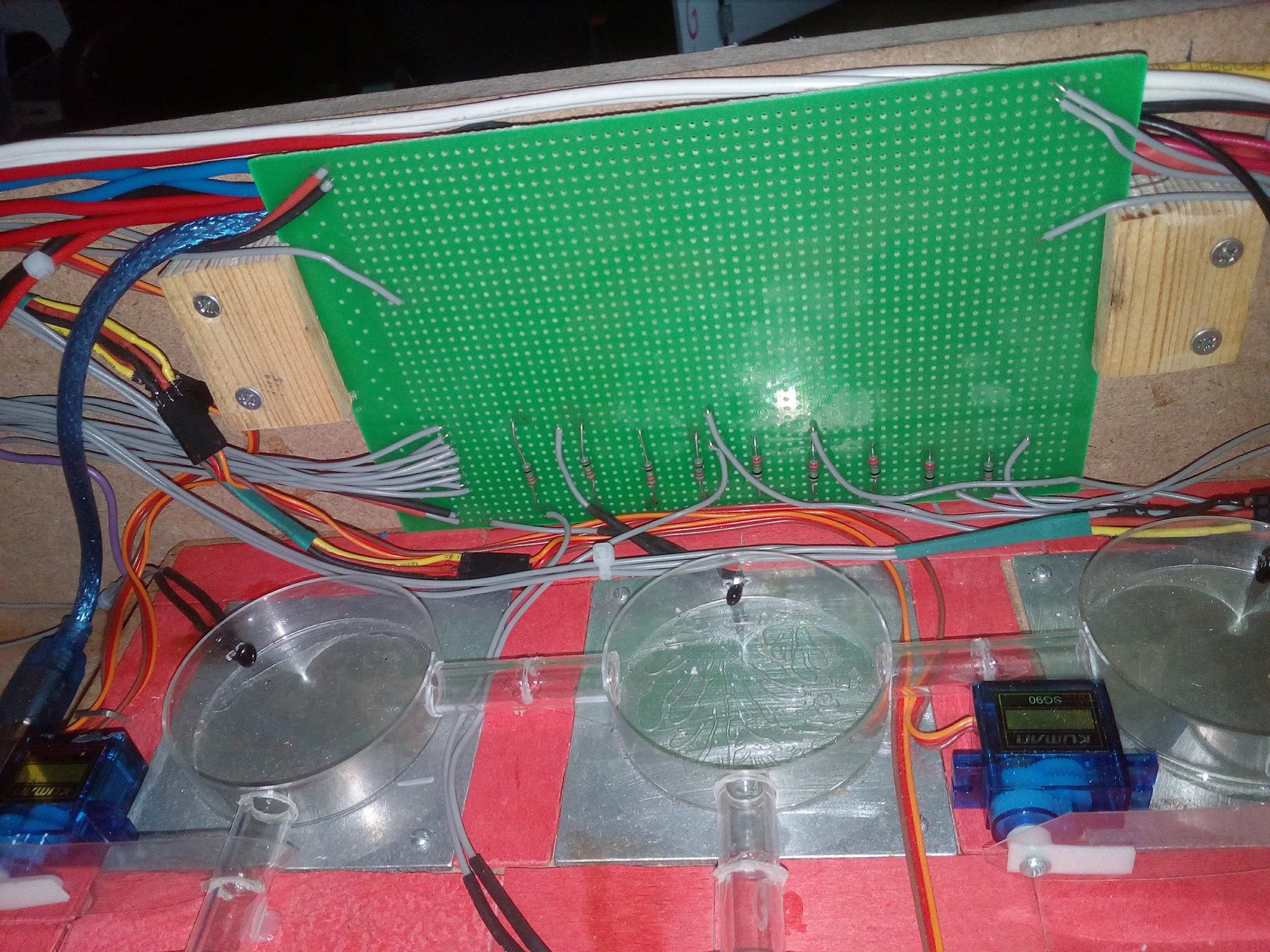

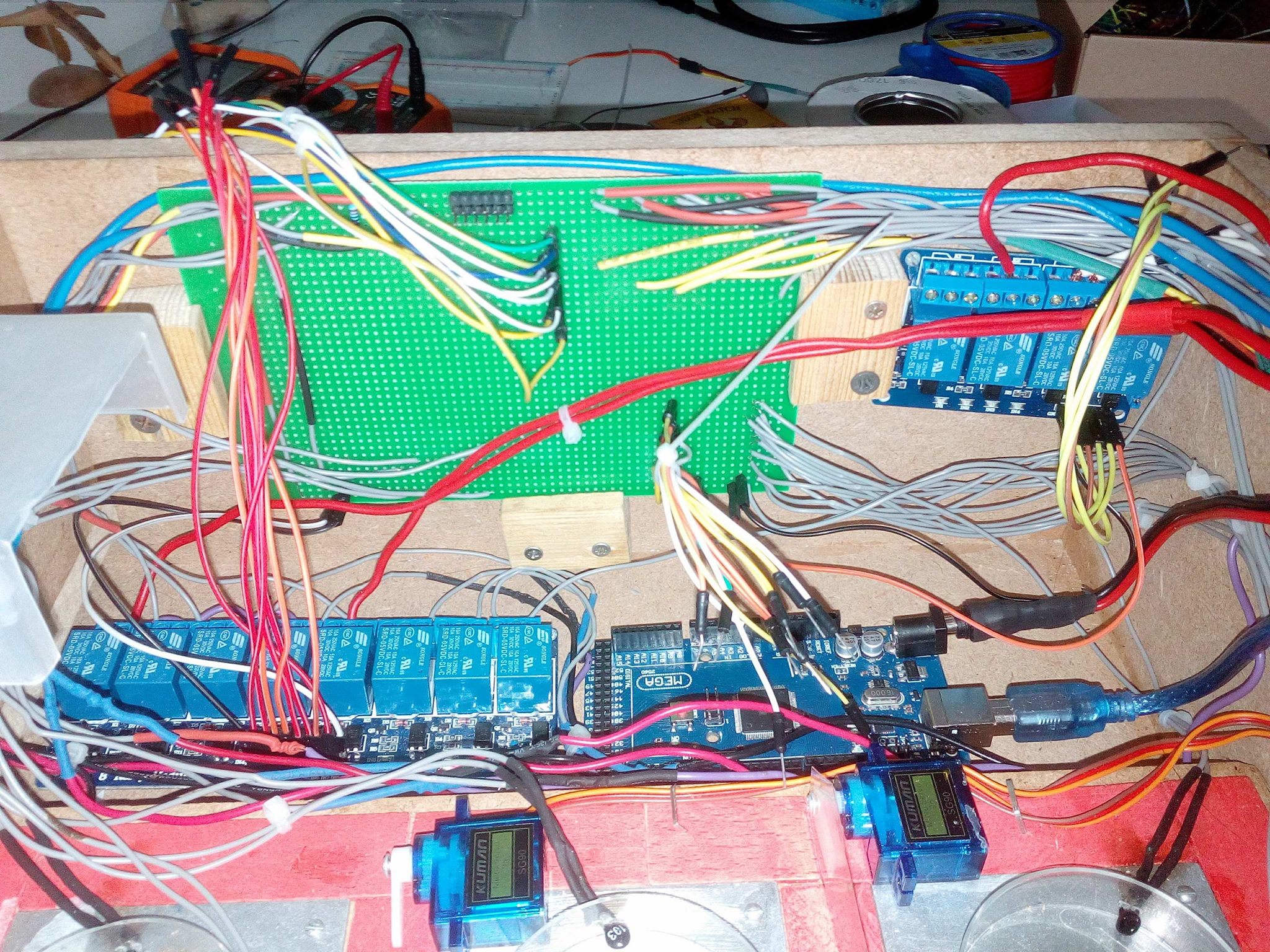

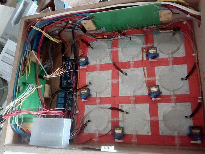

I also put in attachment pictures of the project, but I am not sure those will be helpfull, it's a bit messy in there, since I haven't arrange the wires yet... :roll_eyes:
And the remaining pictures.

So the question is : how do I find the short (if there is one)? I used a 10 Ohms resistor (and got 24 mA) and checked each IC for exessive heat like AdeV said. I waited 15 minutes and found no IC heating... Should I wait more ? Is there something else to do ?
You've not been very clear but I am assuming that when you say "the circuit" you mean all the servos, relays and sensors. Is that correct? Have you tried connecting just "the circuit" to the power supply with the Arduino completely disconnected? What happens then?
According to your diagram if any one of your relays is ever switched it will connect the 5V power line directly to ground. That's a serious short circuit. You probably don't really mean that, but that is what it looks like. And if just one of them is actually wired that way then that will be the cause of the short. And because it depends on a relay being powered you won't be able to measure it without the power on.
Are you sure ? What I meant on the diagram was that the "devices" (which is either Peltier cells, a heating lamp, a fan, or 12 V leds) are connected to the relays on one side, and to the ground on the other side, but the current has to pass through those devices to reach the ground, so there shouldn't be any short circuit, right ? (and the relays are in "normally open" configuration, so if they don't receive instruction from the arduino, the devices never receive current since the "switch" is open)
The top and bottom wires of the relays are there to power the relay's chip, and the wires on the right are those connected in the relays, they are there to power the device... That was probably not very clear on my draft :confused:
