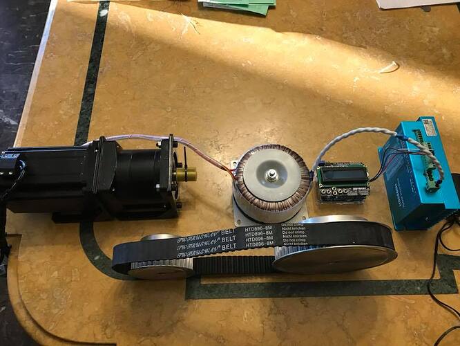

I have to automate a press (for domestic use only!) that requires a force of about 60nm.
I've already bought a 8.7nm stepper motor and a 10/1 matched gearbox that takes the forces involved to what is needed.
I have to write a code that at start (with a simple button) checks first a start and a final end to know the working field in pre-established steps, so after pressing a start button it must start the cycle, check during the cycle the position of 6 microswitches on off, or maybe each one with a resistive value, so that they give information of their value on a single analogue channel to interrupt the process at any time and to warn with a relative message the lack of a component of the process.
What is fundamental considering the forces involved, both the start and the stop of each cycle must be progressive with acceleration and deceleration until the stop before the inversion of rotation.
I thought about using the AccellStepper library 1.57.1.
I see myself on the high seas ... Does anyone know where I can find a draft skretch on which to work?
Use of Arduino UNO, 86HBS85 engine, HBS860H driver.

Please provide a link to the datasheet for your stepper driver.
I suspect it is the standard type that requires step and direction inputs and, if so, you must specify that for AccelStepper using the DRIVER option. The default setting is not suitable for that type of driver.
Assuming you can do experiments without having the motor connected to anything then start with a simple program that moves it 1 revolution in each direction.
...R

You mean Nm (newton-metres), not nm (nanometers)! That's a torque, not a force.
8.7Nm is huge for a stepper - is this a big NEMA34 ? You have a suitable stepper driver for this?
I'd suggest starting with the examples from the AccelStepper library.
A 8.7Nm motor with 10:1 reduction gearing can exert dangerous levels of torque - make sure you cannot
get involved in the mechanism during testing(!) - assume it will misbehave...
For interrupting you should have a single boolean for emergency stop, checked by everything, and
set by a function that also calls stop() on the AccelStepper instance. While the emergency stop flag
is set no calls should be possible other than run() and stop().
Pressing force is expressed in Newtons or kilograms force (kgf), 1 kgf = 9.806N, how much force is required from your press? What kind of mechanical arrangement are you using, lead screw and nut (what is the thread pitch?) or something else?

I use two pulley and toothed belt. the Newton final after speed reducer 10/1 is 87Newton

Yes I must add Emergency STOP, but must put two endpoint first!!! When I turn on machine It must go to the endpoint and assume value for first and last step before start cycle.
All test are do without BELT!!!. When all work fine for long time I connect motor!!!!!
Force or torque? Please be precise with such terms, its really confusing otherwise.
I would use a mechanical switch like a maintained, normally closed, mushroom head pushbutton for E-Stop, don't depend on solid state switches and programming. What is the diameter of the motor pulley? The pulley that moves the "platten"? Can you post a drawing or picture of your apparatus?

I had posted a photo of all components in the first post.
The pulleys are: 14 teeth on the stepper motor, and 60 teeth on the machine
I wont put mushroom head pushbutton at the mount of circuit for break and bypass any solid state component for last security.
@BuckRogers, I can't figure from your various Replies if you have had success with the links I gave in Reply #1. Your link in Reply #4 does not link to a datasheet - but it seems to confirm my guess that the driver takes normal step and direction inputs.
