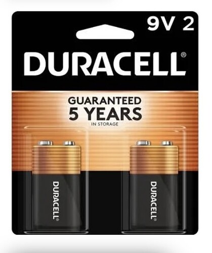

I’m using just regular Duracell 9V batteries like these and not sure if these are the exact power supply modules I’m using but they’re very similar, a capacitor (or something that looks like one) flew off when I ran the 27v through
As I suspected. Those are PP3 batteries designed for low current applications such as smoke detectors. They cannot supply enough current to power the Arduino and two motors. Have you tried measuring the battery voltage when used to power your project ?
Increasing the voltage input to the buck converter (power supply module) will not make them provide more current for a useful period. You would be better off, but not by much, putting the two batteries in parallel rather than in series
As to using 27V to power the buck converter designed for a max input voltage of 12V, I am not surprised that there were problems
