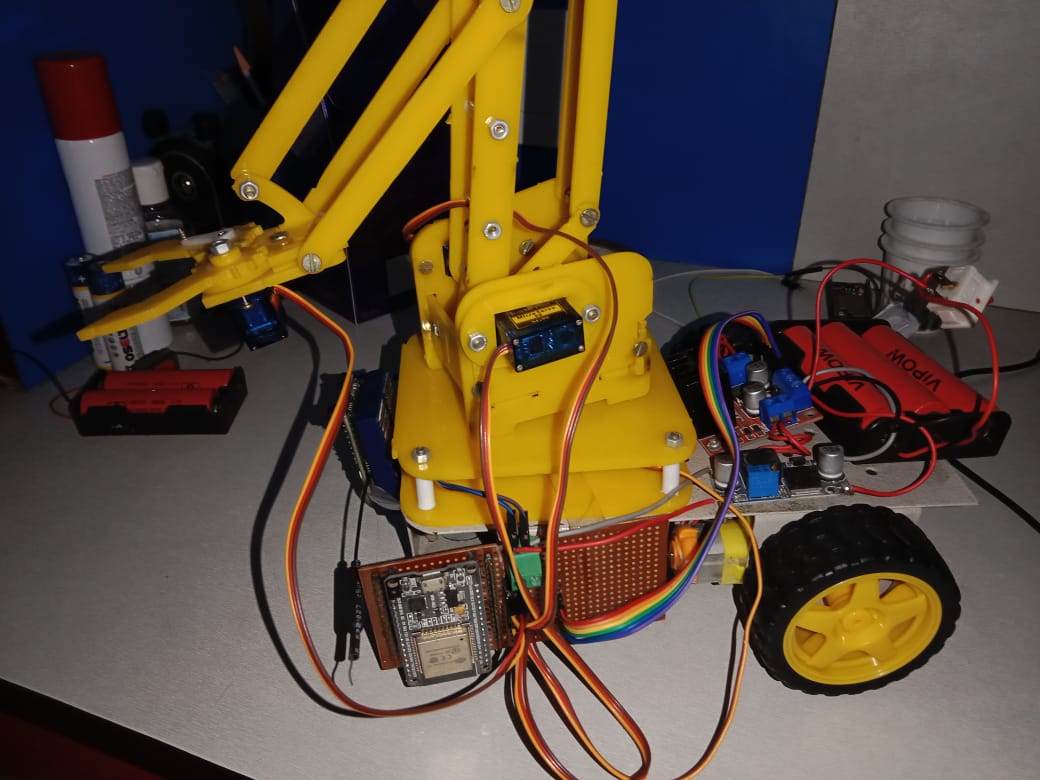

I am trying to build a car with a robotic arm. I am powering the esp32 with 5 volts from a buck converter and the motor driver -l298n with the 7.4 volts directly. It works fine but the batteries get exhausted quickly. When I try to switch the battery voltage to 11.1 volts by adding another lithium ion battery, the esp gets reset as soon as the motor starts. Can anyone tell me why this is happening?
the servo works fine in both cases

If your esp is resetting it is most likely due to a power loss. The pull of a motor is VERY high when it first starts up. Probably too much for the buck converter powering the ESP32. As soon as the voltage drops too low, it will reset the ESP32. Try powering the ESP32 and the motor off separate batteries, rather than sharing them. Or, to try it out, power the ESP32 with a simple wall-wart and a USB cable, just as a proof of concept.
Probably because by increasing the battery voltage you are increasingly the stall current beyond what the batteries can supply, resulting in a drop in voltage when the motor starts, resetting the ESP32.

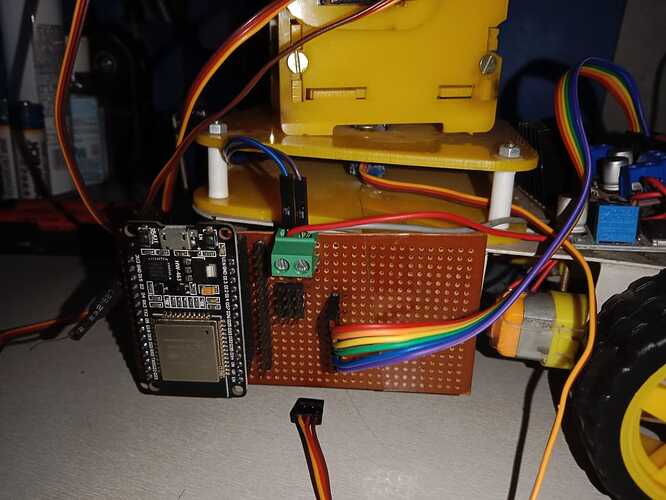

I have tried to make a schematic and I know it is not too good. I have also uploaded the code.
Please excuse me for my bad handwriting and I hope the schematic is understandable. The esp 32-cam has only the camera webserver example code uploaded and it just streams the live footage.
4S Lipo is 14.8V. What's the input thingies of the buck converter? What's the current rating of the buck?
The LiPo's show in the image are most likely 1C, 4 servos and 2 motors may want more than 1amp.
6 motors estimated at 1 amp per motors, would warrant something like this
A bit overkill but it has the ability to supply more than 1 amp without burning up the battery. At 6 amps you'd get about 12 minutes or so of operation.
What Does “C” Rating Mean on a LiPo Battery
Simply put, the “C” rating is the cell’s maximum safe continuous discharge rate. Let’s put some numbers down from a LiPo pack for reference: 5000mAh 20C 7.4V (2S).
I am powering it through 2 lithium ion batteries each of 3000 mah and 3.7 volt. The output current of buck converter is 3 amps max
4 servos need 4 amps, 2 unknown motors which need at least an amp each, for a total of at least 6 amps, you don't see a problem with that?
But the project works when I supply power with 2 lithium ion batteries. When I power it with 3 lithium ion batteries ie: 11.1 volt then it doesnt work.
Also the 4 servos dont work simultaneously so will they still take an amp?
Have you got a DMM?
If so what is the output voltage of the Buck converter with each battery set?
In working and fault condition.
I dont have a multimeter but I have a digital voltmeter.
according to its readings, with 2 li-ion batteries it shows 5 volt constantly and the same with three batteries
