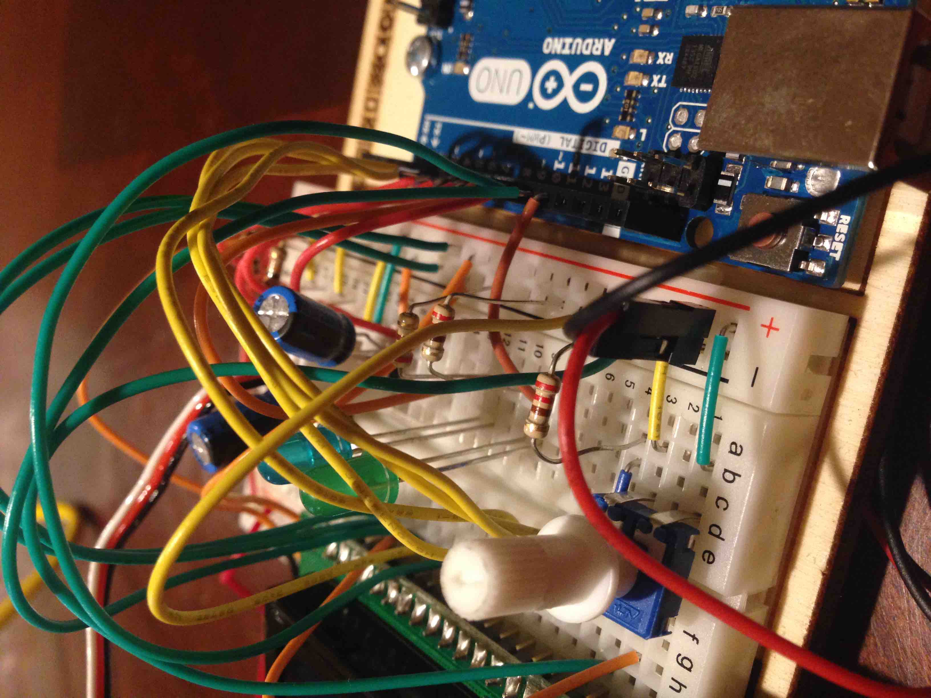

Here are a few pictures of my set up. (sorry in advance for the mess.)
Anywhere with a short? I am kind of lost at this point.
Here is the first picture.
here is picture 2
here is picture 3
picture 4.
Hopefully 1 of these 4 can help.

Didn't I say that photos would NOT be suitable?
Or was I just wearing out my fingers for nothing?

HA sorry I didnt see that but I will draw out my Schematic and upload it soon
