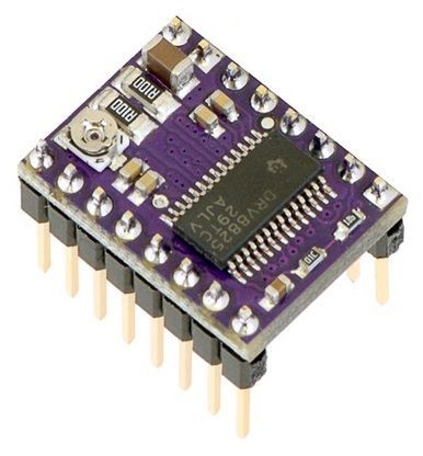

I have connected my Arduino Uno with CNC Shield V3 which has 4x DRV8825 step motor drivers. I am just using this combination to run 4x Nema 17s at certain speed. When my UNO is connected through USB and power the CNC Shield V3 with 12V 2A, the system runs perfectly. But I want to use this setup in offline mode, i.e., without connection to the computer with USB cable.
