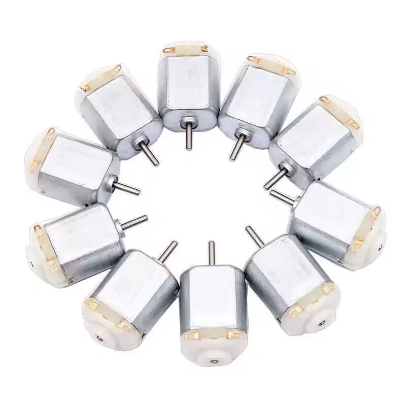

I am building a hobby car project that uses esp32c3 mini board and HBridge (L289). Previously, I was powering the HBridge board separately from the microcontroller using 4 AA batteries connected in series. The esp32 board was powered with 2AA batteries from another battery box.
This setup worked relatively well, however I was quite upset because of the fact that batteries did not last long :(.
Now I am thinking of trying using a powerbank as a source of supply, that would be connected to the esp32 board directly via the USB inlet. And the question is, can I connect the HBridge from the 5V output, without a risk of damaging the board?
The H-Bridge is going to power two small DC motors, I can't find any marking details about the motor, but it's like this: https://ae-pic-a1.aliexpress-media.com/kf/S12e96948f76944ccabc913e16f250c18U.jpg_960x960q75.jpg_.avif
I am worried that the motors would require high current, and the esp32 board will burn because of it.

It's questionable if that is a good idea. The ESP32-C3-DevKitM-1 has a diode between the USB input and the 5V output. It may be able to handle the current but will certainly further reduce the voltage to the motors.

And be aware that the motor voltage will be <4V, L289 is not very efficient driver.

They will last a lot longer if you use a modern MOSFET motor driver, rather than that 1970s dinosaur. The L298 wastes a huge fraction of the battery power as heat.

No, not with that H-bridge. Depending on the motor power source voltage and motor current draw, as much as 40% of the battery power is wasted as heat in the H-bridge chip. The L298 or L293 H-bridges are suitable only for very small, low power toy motors.
