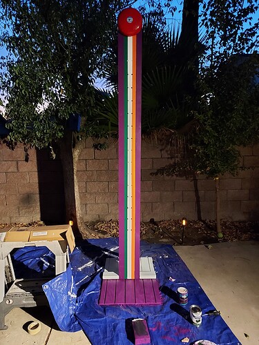

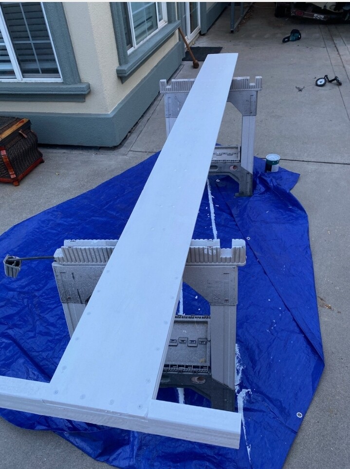

I am working on a school carnival game for the kids' school.
Here is the project so far!
(Sorry if the wiring/stuff is hokey, I plan on putting a back plate on the backside.)
