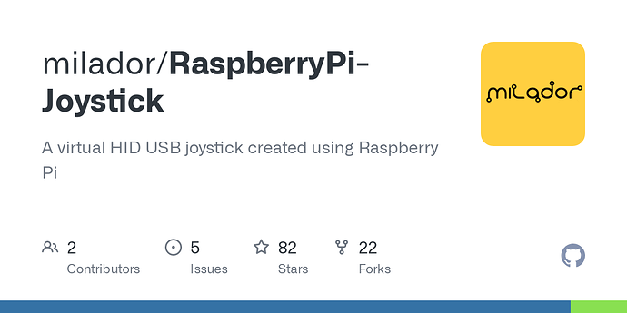

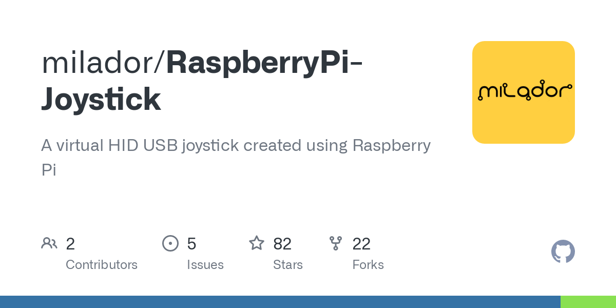

The original ESP32 such as used on the Huzzah ESP32 feather has BT Classic and BLE but does not have a USB controller. The USB serial port is provided by a separate chip which is not capable of HID mouse or keyboard or anything except USB serial.
Your project is pretty complex for a first time microcontroller project.
A Raspberry Pi Zero W board can do this but they are in short supply. And are more complex to program.
The list price is $10 but most places are out of stock. Scalpers sell the boards with outrageous mark ups.
There is a very interesting project that uses a Pi to get BT HID events from a
wheelchair joystick then converts the events to USB HID joystick events going out the UST OTG port in USB gadget mode.
The board runs Linux so maybe it has the same driver for the Apple trackpad. The other half is to emulate a USB HID mouse on the USB OTG port. There are examples of how to do this.
