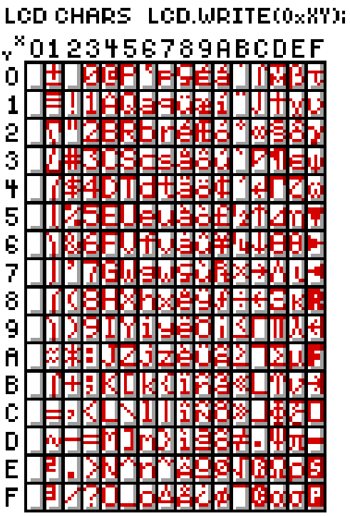

Edit 2:
I wrote down all the symbols I got on the digital version, hope this helps anyone who has the same problem
