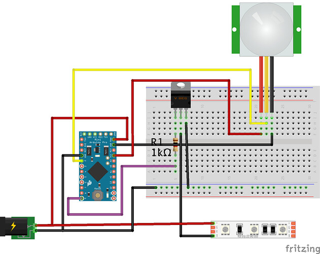

It seems that I somehow fried one of my pro minis RAW input. I can still power it on via the 5V VCC input and it'll run basic code correctly. However when I power it through the RAW input nothing happens. Nothing seems physically damaged on the board hence my reluctance to replace the voltage regulator before what's actually broken. Would you guys know a way I could repair this board or am I confined to use it only through the vcc pin at 5V?
Here's the project I'm attempting to build. So far I was able to put it all together on a breadboard (minus the resistor). When I tried to make it more permanent though the board seemed to have shorted out. I have other boards available to replace it but I'd like to prevent such thing from happening again. It was powered through 12V 5A.

Avoid idiot Fritzing diagrams, as they are usually confusing and misleading. What is the black thing labeled "VREG" and what are the associated pins?
It's a semiconductor. Model TIP31A.

Do you have a better alternative for Fritzing? It was actually meant for future personnel reference.
Thanks!
A hand drawn schematic, with care taken to properly label components and connections, is almost always better than Fritzing. A simple rectangular box, with labeled pins, works for most modules like Arduino, voltage regulators, etc.
Note that a TIP31A NPN transistor has no relation whatsoever to a "VREG" or voltage regulator, which illustrates my point.
I use professional schematic preparation programs, i.e. LTSpice (free, and also does circuit simulation) or Eagle (which produces circuit board designs). There are many others.

A ProMini has a tiny 5volt regulator without heatsink.
With 12volt on RAW (V-in) you can't draw any power from a pin (for a LED, etc) without overheating that regulator.
Use a micro-power buck converter set to 6 or 7volt, or set it to 5volt and connect it directly to the 5volt pin.
What are you trying to drive with that TIP31.
A TIP31 with 1k base resistor is fine for driving a single piece of LED strip (as in the Fritzing picture).
But don't try to drive more than one section with it.
