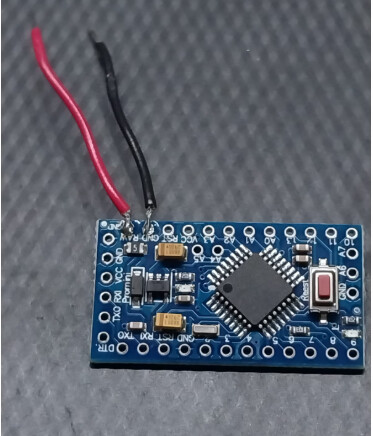

I received my Pro Mini's 3.3V 8MHz today.
But the chip on the board is 328PB.
There is no PB version in the Pro Mini board selection so I programmed the Pro Mini with Blink selecting the 328P version.
The code uploaded and the L led is blinking.
But now I cannot program it again.

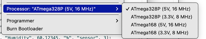

What have you done to try to get it working? Make sure the Tools/Processor is selecting the correct value, and kill the IDE in case you left a serial monitor running in the background.

Hi @mikedb. Please provide a list of the connections you made between the pins on the USB to serial converter and the Pro Mini.
Device Manager shows COM1
The problem is there is no 328PB version in the Pro Mini board so I used 328P.
IIRC, the PB is an improved 328P with more peripheals but it is backwards compatible. Nothing that affects uploading, but you will likely NOT be able to use the extra I2C, USART, SPI, 2 more pins etc. Just make sure you select the right processor on this menu
The error you are encountering is a typical Win device manager thing. If it worked once then it will work again, just make sure you kill all remnants of the IDE and try again or a few times.
I watched a few videos before I programmed the Pro mini.
All the videos shows.
TX ----TX
RX-----RX
That looked weird but I tried it.
Upload = 100%
Cannot upload again.
I swapped TX and RX
TX----RX
RX----TX
Now I can upload again , changed the Blink rate 3 times and the led pulses change the same as in the code.
My Pro Mini is working again.
Thanks.
