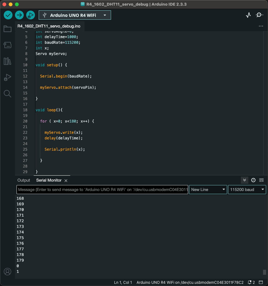

Problem getting SG90 to increment in single degrees 0-180
I have a MicroServer 9g SG90 attached to pin D3 of an UNO R4 Wifi. I am trying to step through each degree between 0 and 180 one by one with 1sec delay, but it fails to move on every increment, skipping roughly 9 out of every 10 degrees on average. Am I expecting too much from this component? My (debugging) sketch includes Servo library by Michael Margolis v1.2.1 :

Sounds like you've run into this problem:
The latest release of the Servo library (1.2.2 as of this writing) apparently includes the fix by @KurtE to address this problem.

That makes steps 0 to 180, inclusive, which yields 181 steps.
Try this for 180 steps, 0 .. 179
for (x =0: x < 180: x++) {

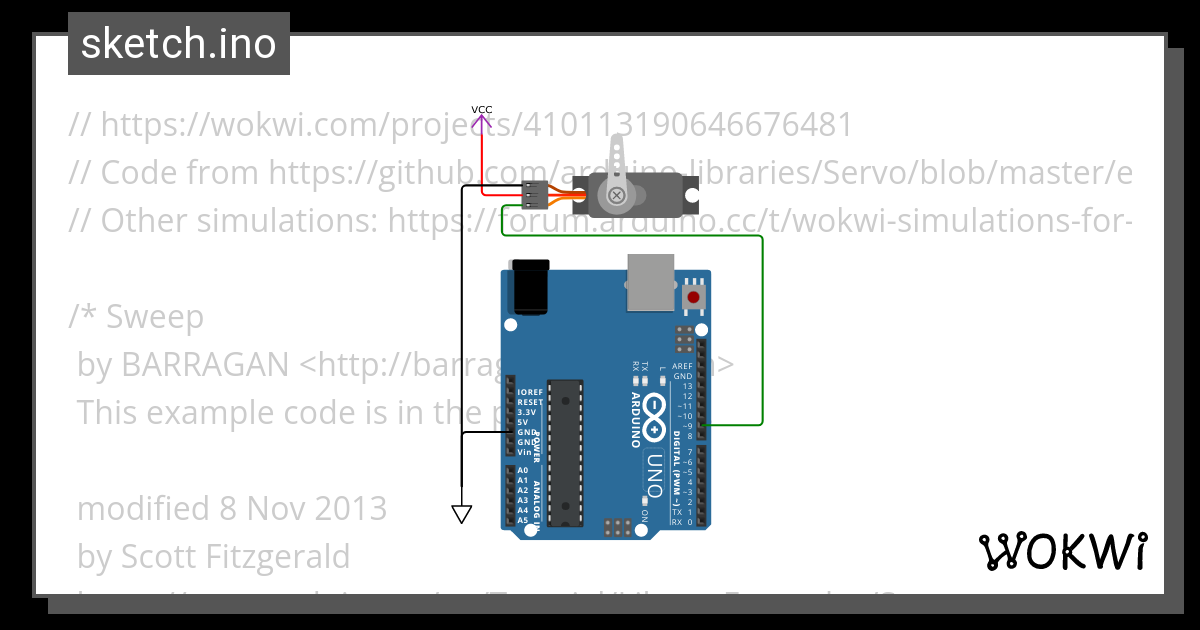

Here's some non-jerky movements on an Uno in Wokwi:
Thanks xfpd. x represents a specific angle writen to the servo, and I wanted to start at 0° and end at 180° so I guess that is 181 steps as intended.
I initially coded:
but then noticed the serial monitor was only counting up to 179 before returning to 0:
So I went to 181 as a 'quick' fix :grin:
Thanks DaveX. Yes... I hadn't noticed that. They're definitely not 1° increments are they. Now that my sketch is working the change in movement is quite slight and very smooth.
Thanks also for introducing me to Wokwi... will definitely be having a play with that!
