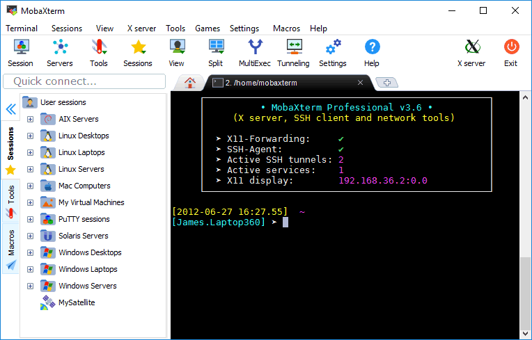

My incoming byte will be in Hex. It Varies from 0x00 to 0xFF. How to send the data from Serial monitor to test this?
Is there anyother option to test the incoming byte of Hex Value 0x00 to 0xFF in the Serial. Kindly let us know.

You can't with Serial Monitor because it's for ASCII characters, not binary. You could just try kinda fake mapping a specific character (one you're pretty sure it can't be part of a message, let's say '*') to 0xFF, something like:

I just had some test, and I can say you can try MobaXterm with those settings (except the specific COM port and speed you have on your system):
This way, you can use "Alt-numkey" to send binary, like "Alt-255" to send 255 or 0xFF, this sketch is my test sketch:

and this is the output when I type Alt-255, Alt-254 and alt-128:

Hi, Can you please share the download .exe file for MobaXterm terminal software. I found lot of version in it. Thanks.
Hi Sir, Can you please share the download .exe file for MobaXterm terminal software link. I found lot of version in it. Kindly help on this.
No need to share any exe file (besides, I won't ever do that for obvious security reasons), MobaXterm is a free software, you can download it here for free and use it for personal purposes:
