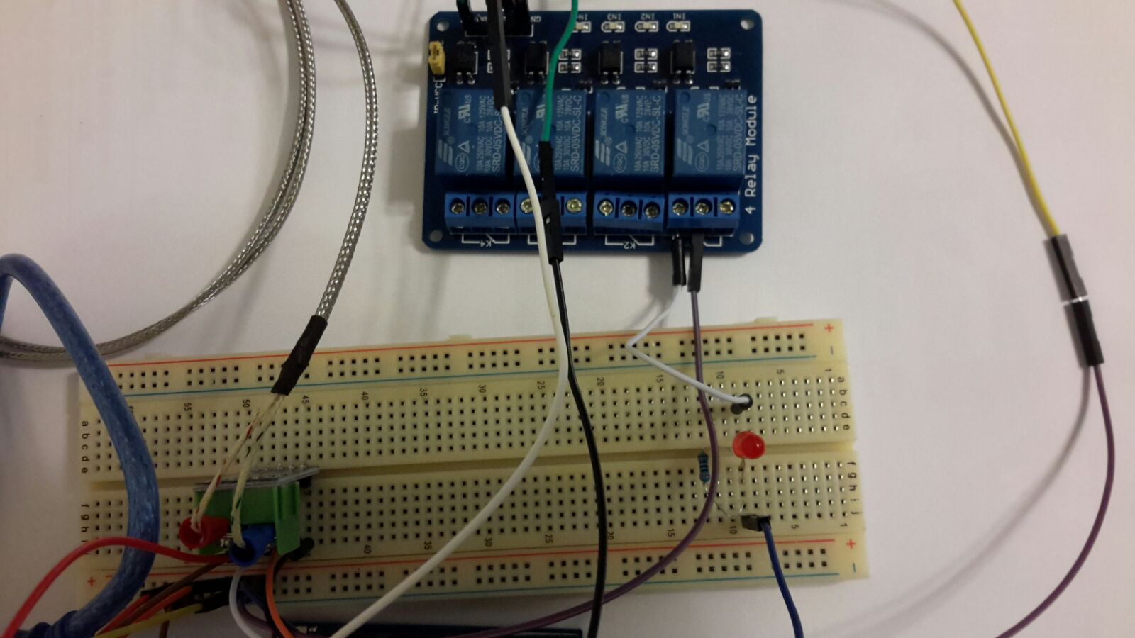

4 Relay Module 1st Relay NO port --> breadboard at LED
4 Relay Module 1st Relay COM port --> Ground
breadboard at the other end of LED --> 5V in Uno board
4 Relay Module IN1 port --> 4 port in Uno board
4 Relay Module VCC port --> 5V port in Uno board
4 Relay Module GND port --> GND port in Uno board
The coding is as follows. However when the arduino is executed, the LED does not light. I have tried to light the LED without using the Relay module. It works. Are there any error in using the 4-Relay Module?

I can't see where the wires are going, but I've got to assume something's wired wrong...
This is might be unrelated, but your current-limiting resistor is not in series with the LED.... Your LED could be fried, or the lack of a resistor could be "killing" the 5V and crashing the Arduino.
Do you hear the relay clicking? If not, disconnect the LED and listen for clicking.

From your images, I cannot figure out how everything is powered ... note that the relay board cannot derive power from the Arduino except for powering it's opto and visible LEDs.
After connections and powering is OK, there a possible issue in your code. You may need to reverse the order of pinMode and digitalWrite in your setup or the relay will energize for 500ms. Also use digitalWrite(relayPin, HIGH) to ensure the relay stays OFF (the relays are active-low trigger).
Reversing the order like this influences the default condition of pinMode (changes it to default HIGH on the pin).
Hey guys, this OP did the same thing as the other one. He put BOTH leads of the resistor in the SAME row !
The led is fried because there was no resistor in series. He needs to remove the resistor and rotate it 90 degrees counter clockwise, move it over so one end connect to the led and then move the wire to the other lead, and replace the led.
