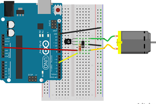

I'm trying to run dc motor mt64to arduino uno using example from johnny five tutorial, but when I run my script, I hear only high pitch sound and the motor's not moving.

Any suggestions what I'm doing wrong? The motor is fine. When I change pin ~5 to 5V pin it spins.
Thanks for any help.
Please post your code and your schematic.

DO NOT do what then say, you are in danger of ruining your Arduino, never try to drive a motor or servo directly from your Arduino, it can not cope with the current demands of a motor, unless a very low current, as the arduino can only supply about 40mA. OK for LEDs but not much else, you need at least a transistor to act as a switch or an H-bridge if you want to reverse it..
The high pitch hummmmm is not a good sign.

Thank you so much, Cactusface. I've used H-Bridge tutorial, and it works well!
