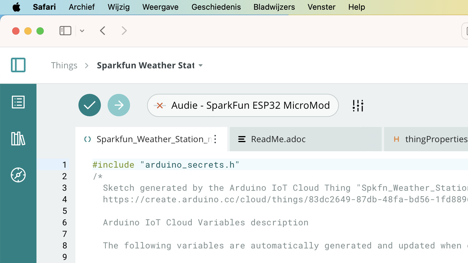

I am using an iMac with an M1 chip running macOS Sonoma and purchased the SparkFun Arduino IoT Weather Station.
The web editor does not recognize the SparkFun ESP32 MicroMod.
The LEDs on the MicroMod weather Carrier Board light up and the LED on the ESP32 MicroMod flashes.
The installation of the SarkFun ESP32 MicroMod was completely done according to the installation procedure as described on projecthub.arduino.cc.
I tried it also on a Windows machine and with different browsers and also tried several cables, but that did not help.
I hope someone can help me...
Hi @dirk3257. This is caused by a bug recently introduced into Arduino Cloud that affects uploading IoT Thing, and dashboards sketches to serial ports of ESP32 and ESP8266 boards. The Arduino Cloud developers are aware of the bug and are already working on a fix. I will report back here if I have any news to share regarding a resolution.
For now, please use Arduino IDE when you need to upload Arduino Cloud IoT Thing sketches to ESP32 and ESP8266 boards via the serial port. You can install support for the ESP32 boards in Arduino IDE by following these instructions.
You can use the Arduino Cloud sketchbook integration feature of Arduino IDE 2.x to get convenient access to all your Arduino Cloud sketches (including Thing sketches) for use in Arduino IDE:
https://docs.arduino.cc/software/ide-v2/tutorials/ide-v2-cloud-sketch-sync
You can continue to use Arduino Cloud to set up IoT Devices, Things, and dashboards, to write and compile sketches, and to interact with the Thing via dashboards. The only problem is the inability to upload to the board via the serial port. The bug does not occur when using a non-IoT sketch so you can work with non-IoT sketches in Arduino Cloud, including uploading them to ESP32 and ESP8266 boards, just as always.
The bug is specific to serial ports. Arduino Cloud also has an OTA (over-the-air) upload feature that allows you to uploading to boards via the Internet This feature is available if you have an "Entry" Arduino Cloud plan or higher. You must use the serial port to upload the IoT Thing sketch to a board for the first time, or if the board is no longer able to connect to the network using the credentials that were configured the last time the sketch was uploaded, but once an IoT Thing sketch is running on the ESP32 board with access to the Internet, it will produce an OTA port. You can then upload to that OTA port via Arduino Cloud. So the workaround of using Arduino IDE to upload the sketch is only required in cases where the board is not producing an OTA port.
