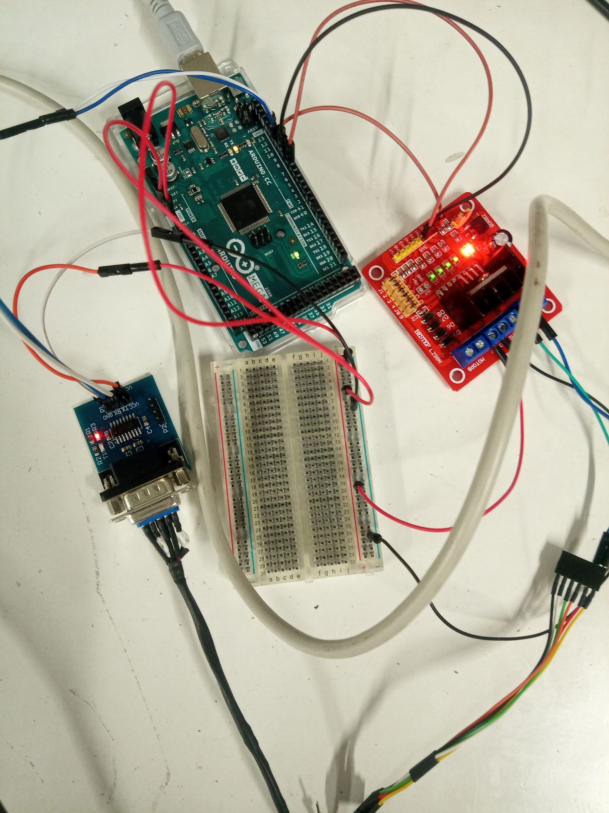

Hi there, I am new to Arduino and I am hoping someone could help me.
My aim;
To receive height measurement data from rs232, convert into TTL to be displayed on the serial monitor, then put that measurement data into a variable, using this variable to detect when minimum & maximum height values are reached and then have a delay for 2 minutes at each end.
The product has a DC motor which drives a lever up and down, the lever height is measured & has a min and max between 24.885 ---> 25.225. These are the values where I want to turn off the DC motor.
Kit I am using;
Arduino Mega2560
L298N H-Bridge
RS232 to TTL converter
How far I have got;
I have managed to read the RS232 measurement data in the serial monitor and assign it to a variable.
& I can drive the motor up & down at different speeds and directions fine!
Problem I'm having;
When my code runs, the motor fails to stop at the specified heights (or doesn't drive at all). I need the motor to stop at value 25.225, delay for 2 minutes then change direction to minimum setting and stop and delay for two minutes & loop continually.
I'm 99% certain its my bad coding, any help would be greatly appreciated!
Thanks for your time!
PS: I'm using software serial for now as the project will move onto a Uno when purchased

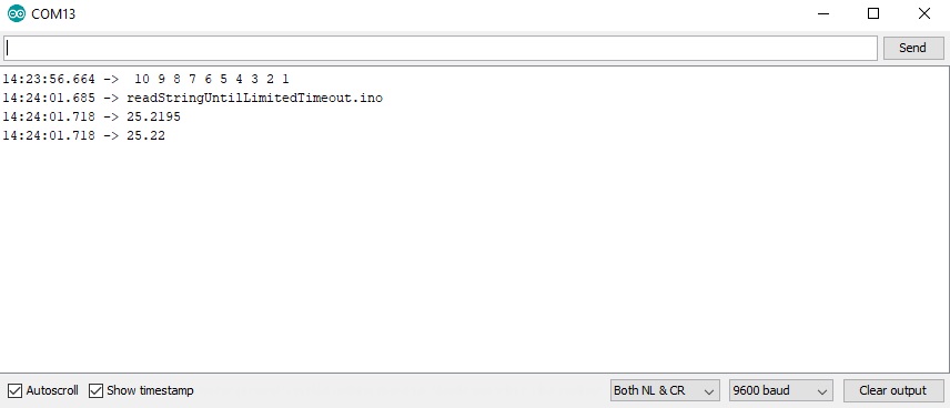

Thank you everyone! I will continue the project tomorrow and post again with my progress! :slight_smile:
To read an input and convert it to a float see my (draft) tutorial on Arduino Software Solutions It has a variety of solutions for reading text from Serial and converting text to int/float with pros and cons for each solution. Choose the one that suits your needs.
For your delay problem check out my tutorial on How to write Timers and Delays in Arduino
My tutorial on Multi-tasking in Arduino is worth a read also now that you are doing more then just one thing

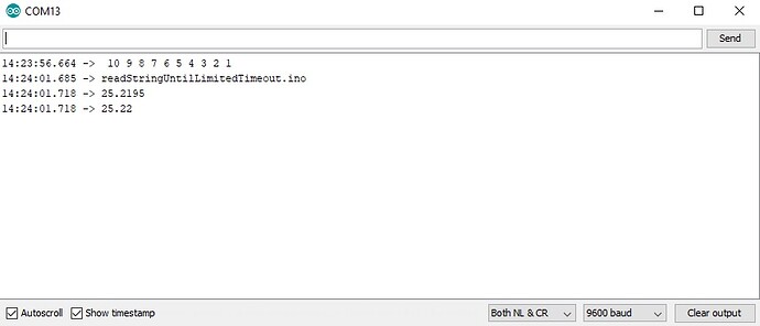

Things are better now, String is displaying correct value except with two spaces before the first number, but the float variable is still saying 0.00.
I am assuming this is because my string has too many spaces at the beginning. Please help!

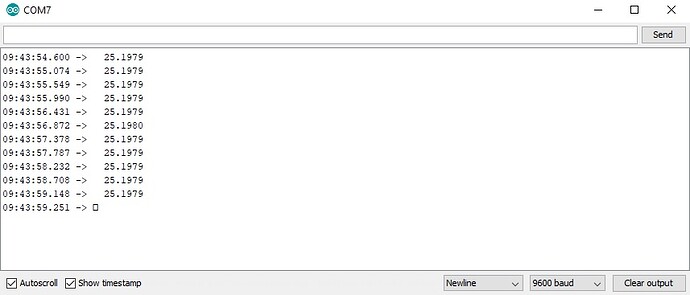

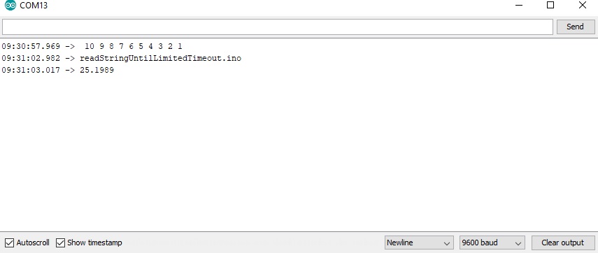

Thanks Wild Bill, I may have prematurely post, managed to get my FloatRad to accept the values by removing the character spaces in the string, and explicitly adding the toFloat() line of code to the correct location.
It is now only giving me two decimal places when I need 4.
And I am looking for a repeat reading, and it seems to just give me a reading just once?
I will be researching a lot to find the solution but if anyone can save me time with your wisdom, I would be grateful!

Serial.print defaults to two decimal places. Add ,4 to get four.
Thanks Wildbill that is all sorted now!
Now the only things that need to be done to complete this is.....
Have the serial monitor display repeated measurements, the rs232 device sends this information, maybe a couple of times a second.
With the original example from drmpf, it did this fine. Until I added the motor stuff into it , using voids and calling them in the loop and now it seems to just want to print the measurement in the serial monitor once. I'm guessing this is why the motor also isn't driving.
I think this is because I need to implement some multi-tasking with millis(), I will be working hard to figure this out.......but if anyone knows and wants to save me some time :wink:

Problem is I'm still only getting a single reading, see photos labelled singlereading and repeatedresult. Because I am only getting a single reading I'm thinking this is why FloatRad won't change.
I thought at least the motor would run though, just the variable wouldn't change so it would run forever. Is this because I need to implement some multi-tasking? Thanks again
