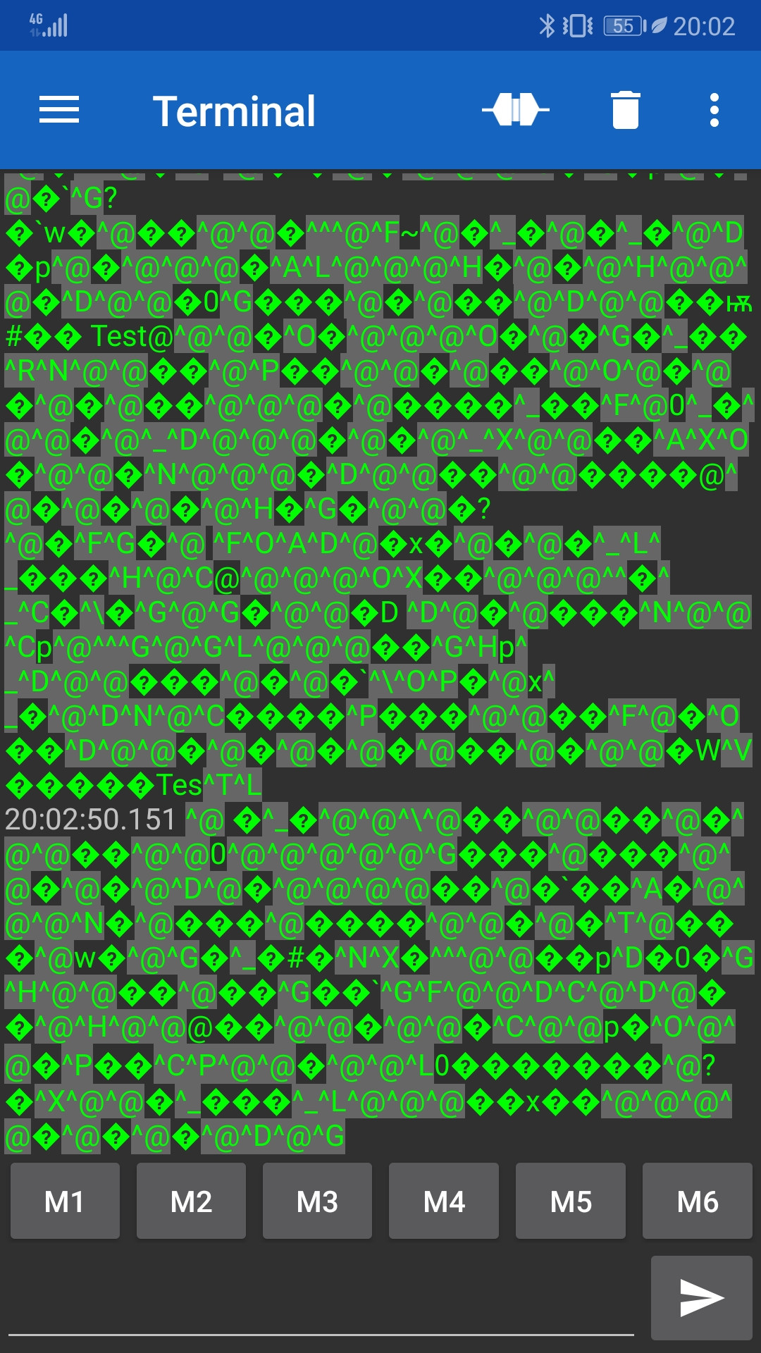

Doesn't matter if I'm trying with my app or with other Bluetooth Serial Terminal apps on the store, whenever I send the letter "a" from my phone to the Arduino board, I get either a reversed question mark or a multitude of random characters.
I've spent my whole day trying to figure it out and nothing came out of it.
The latest sketch I've tried should display the text "Bluetooth Test" on both my Bluetooth Serial app and also on my Serial Monitor. In the pictures below you'll notice that it says "Bluetooth Test" on the Serial Monitor, while in the app there are a bunch of random characters.

Next, I will post a link to Imgur with pics of the Bluetooth Module, the board, a screenshot from my phone showing the weird characters, and a screenshot of my PC showing the code and also the Serial Monitor: Imgur: The magic of the Internet
TL;DR I want to send a character from a Bluetooth Serial Terminal app to my Arduino via the HC-05 and weird characters show up instead of the wanted character.

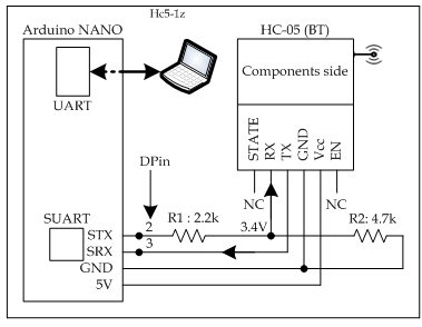

gflu:
Connected the VCC of the module to my 5V rail, the GND to GND, TX to Digital 3, RX to Digital 2 trough a voltage divider.
1. According to your above description, the connection that you have made between NANO and BT is depicted in Fig-1.
Figure-1:
2. Based on Fig-1, the object constructor code is:
SoftwareSerial BTserial(3, 2); // SRX | STX
And not the following which you have included in your sketch.
SoftwareSerial BTserial(2, 3); // RX | TX
3. Connect the PWM-pin of a Servo (SG-90) at DPin-5 and upload the following tested sketch. Send 'a' from your Android Phone and check that the Servo rotates by 450.

Did exactly as you said and it doesn't move.
Made sure to properly wire the Bluetooth module as per your description.
I still get those weird characters on my Serial Terminal on my phone. You can see what I'm talking about in the fifth photo if you access the link: Imgur: The magic of the Internet
The image of the phone screen LOOKS like a mismatch of baud rate. If you have NOT been fiddling about with AT commands, it may be because HC-05 is set to a non-standard rate out of the box. I have heard rumour of this but I have never known if it was true. This might be the time, so you might try changing the software serial to different standard rates

Make direct and single jumper connections between NANO and BT. Avoid the use of intermediate jumpers that cause problems. Use 5V of the NANO for the BT and not the external 5V. Have you uploaded my sketch of Post#9 that I have tested in my setup?

I thought about the fact that the module could be set on a different baud rate and I tried using the command AT+UART? in the serial monitor but it doesn't show anything at all, not even what I wrote.

The wiring is as follows: USB Inserted into Nano. Vcc of HC-05 inserted into 5v of nano. Gnd to Gnd of Nano. Tx into Rx. Rx into Tx through a voltage divider made out of one 1k resistor and one 2k2 resistor. On pin D5 I connected my Servo, as GolamMostafa suggested in post #8.
