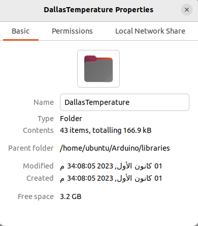

Hello! I have a problem that I have been trying to solve for half a day and have searched everything - it does not find the OneWire, DallasTemperature libraries. I have the code in Visual Studio Code, I installed the libraries in the Arduino IDE, and they are displayed there. I inserted the path to the libraries into the c_cpp_properties.json file:
    "configurations": [
        "name": "vscode_avr_c_properties",
        "includePath": [
          "${workspaceFolder}/**",
          "/usr/lib/avr/include",
          "/home/ubuntu/Arduino/libraries/**"
        "defines": [
          "__AVR_ATmega328P__"
        "cStandard": "c11",
        "intelliSenseMode": "gcc-x64",
        "compilerPath": "avr-gcc"
    "version": 4
I copied the path from the properties:
VirtualBoxVM_pCyox6v9Rl
A screenshot of the error itself:

Please do not post in "Uncategorized"; see the sticky topics in Uncategorized - Arduino Forum.
I have never heard of such a file but, if you really have installed the new library in the same folder as all the other libraries, it should work. Just in case you haven't already done it, you need to restart the IDE when you install a new library.
Can Visual Studio use libraries installed in the Arduino IDE? I don't know.
Does the code compile if you use the Arduino IDE to compile it?
