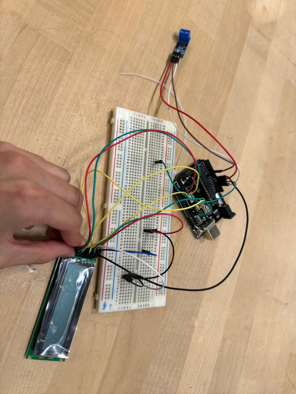

Hi, I'm currently working on a project related to LCDs. I want the LCD to display a message if enough current is inputted. But, when I assembled it I think I wired my LCD wrong. Is it possible to check where I went wrong?
Here is what the LCD looks like when it is connected to the circuit:
The pins connected to the Arduino are:
The wire on the 1st Column 6th Row: Vss
The wire on the 2nd Column 6th Row: Vdd
The wire on the 1st Column 5th Row: RS
The wire on the 2nd Column 5th Row: V0
The wire on the 1st Column 4th Row: R/W
The wire on the 1st Column 4th Row: E
The wire on the 2nd Column 2nd Row: DB5
The wire on the 1st Column 2nd Row: DB4
The wire on the 2ndColumn 1st Row: DB6
The wire on the 1st Column 6th Row: DB7
The wire on the 2nd Column 1st Row: Vss

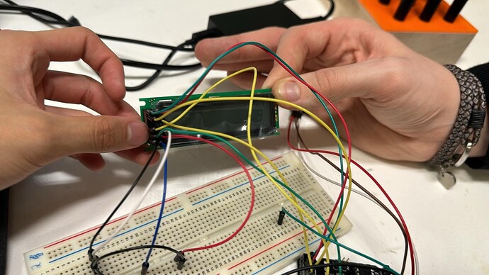

can you post a zoomed / in focus picture of the connector with the wires so that we could see any marking ?
did you solder the headers there or were they already soldered?
The third one
1. This is the signal signatues (Fig-1) for the 14-pins of the Header connector of your LCD. You can easily find out the pin numbers.
Figure-1:
2. From figure of post #1, it looks like that you have already soldered female header on the empty holes of the Header. Now, consult Fig-1 and make conection between lCD and Arduino UNO. You need to feed 5V supply with a series resistor for te back light ofthe LCD.

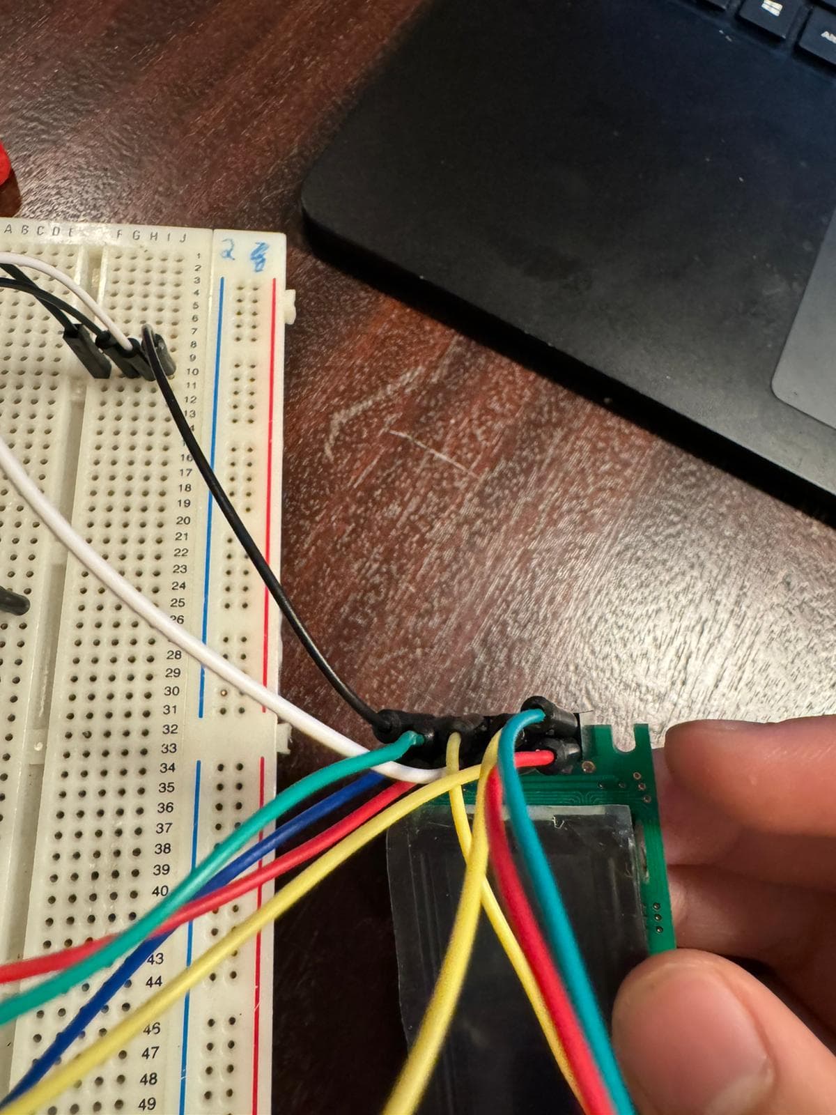

The connection isn't soldered yet cause I want to make sure the wiring is connect before I solder the wires to the LCD.
Here is also a better picture of the wiring. I'm really sorry that I didn't make it clear enough when I took the original photo.
Also I am having issues with over heating. Where should I put a resistor?
Thank you so much! I can see the pins much better. I'll made the connection with the arduino and the LCD lights up but its overheating now. So I'm considering adding a resistor but where in the circuit should I put the resistor?

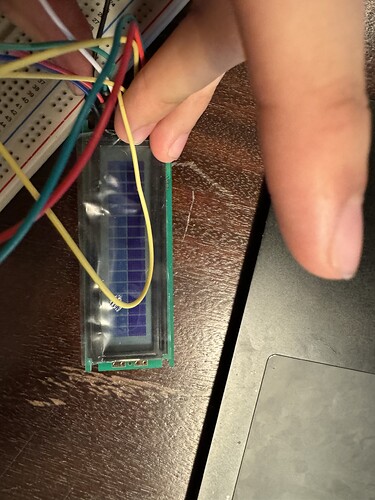

Also when I connect it it shows a bunch of blue boxes. What do these mean?
You mean the female headers ? It needs to be soldered for the LCD to work. There is high frequency communication happening on those pins and the connection needs to be good.
If it’s warm it mightmeans you need to limit the backlight current - add a resistor there
The blue squares might just be the need for a contrast potentiometer somewhere to be either added or just tuned if it’s already there

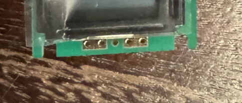

Thank you so much! I think I understand it better now but I am confused why there are 16 pins on the LCD. My one only has 14 so should I bypass the connection with LED- and LED+? The one I have is pointed out by @GolamMostafa
are those pins on the other side connected to anything ?
the Chinese text mentions a LED with a forward voltage of 4.2V and at the bottom they mention 10Ω to 100Ω... would be good to understand exactly what that text means
Not really. It’s just there.

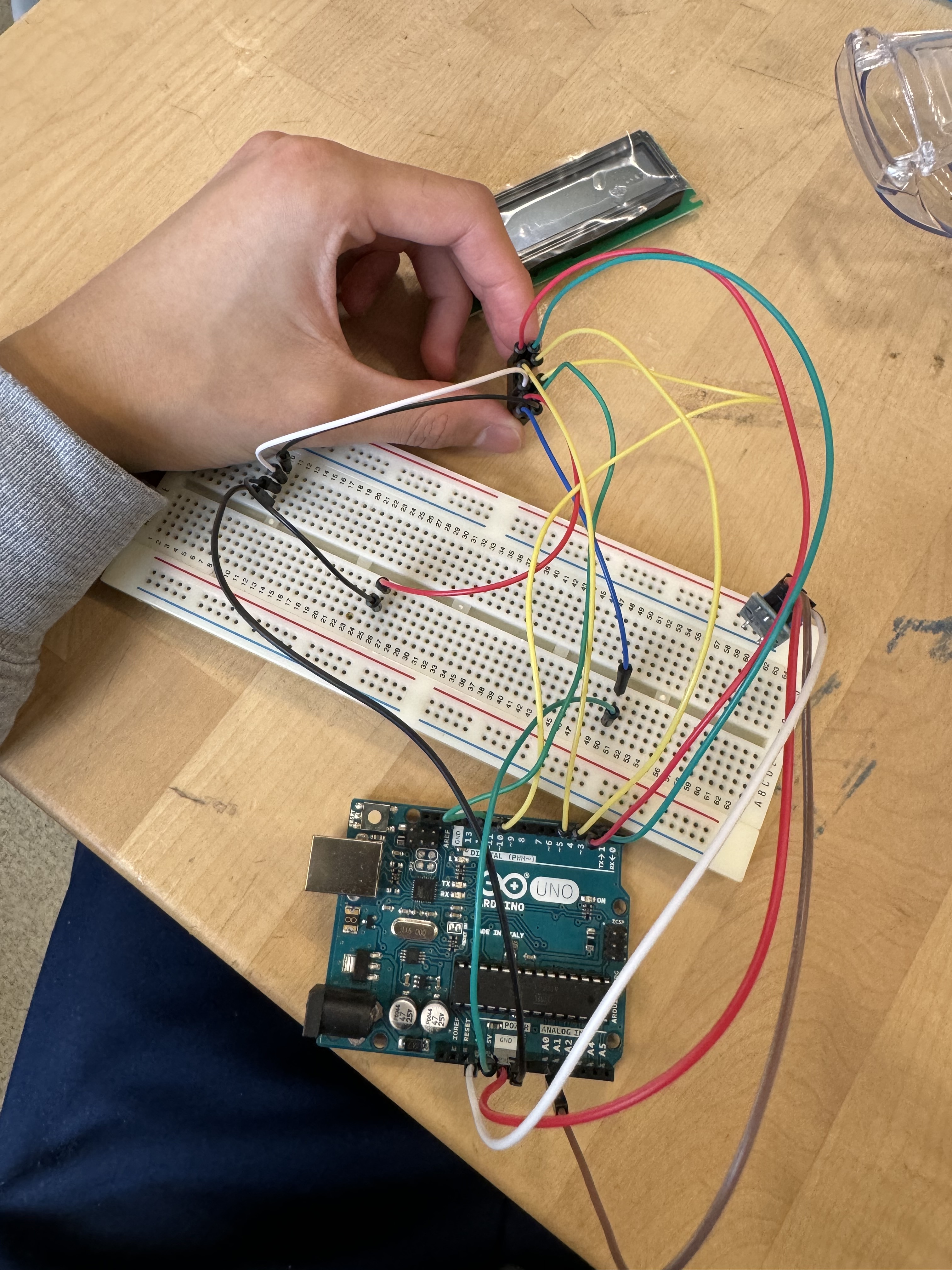

This is what it looks like after I soldered it. I don’t have a potentiometer and I am looking for a way to by pass it

➜ You don't have an I2C LCD. you can't use that code to initialise the LCD. instance
refer to the tutorial I pointed out earlier, you'll see they do something like this with the LiquidCrystal library not the LiquidCrystal_I2C one.
// include the library code:
#include <LiquidCrystal.h>
// initialize the library by associating any needed LCD interface pin
// with the arduino pin number it is connected to
const int rs = 12, en = 11, d4 = 5, d5 = 4, d6 = 3, d7 = 2;
LiquidCrystal lcd(rs, en, d4, d5, d6, d7);
use a couple resistors. You won't be able to change the voltage but at least you could "simulate" a potentiometer set at a given point
