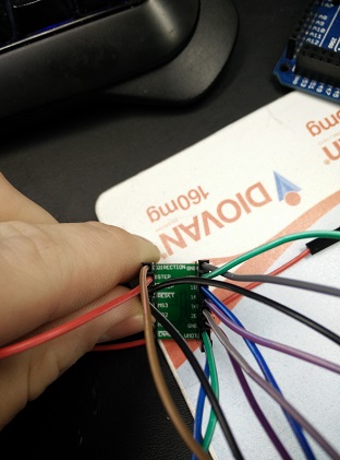

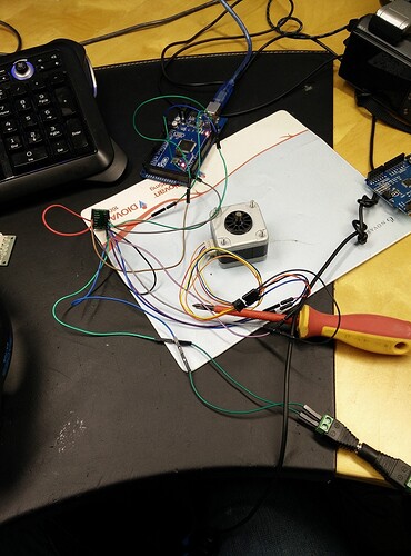

Here are some pics:
Use the wiring diagram on the Pololu A4988 webpage. Your code looks like it should work. There is also simple code in this demo
Photos are not a good way to show wiring connections. When you want to show wiring draw a diagram (in pencil is fine) and post a photo of the drawing.
Are you powering the motor from a PP3 9 volt battery? They are completely unsuitable as they can't provide enough current.
Post a link to the datasheet for your motor?
