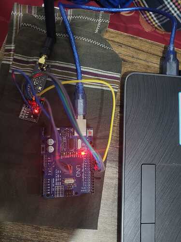

so i bought 2 PA/LNA nRF24l01 modules off of amazon and i tried testing whether they work or not. i have a single arduino so i tried testing them one by one. AND both of them give "weird" values. I've rechecked my wirings multiple time, but still either i get this:-

so what's the problem? ive always plugged the VCC to 3.3v of my arduino uno. could it be power related? the arduino is connected to my laptop during compiling and uploading.

How exactly did you test the modules when you only have one Arduino ? What sketch were you using ?
The modules are very power hungry and need to be fed with a suitable power supply. It is common practice to put a large value capacitor across the power connections of the modules or even better to use something like this 2 Pieces Adapter For Module Wireless NRF24L01 +2,4Ghz Card Arduino 8025702023913 | eBay

Oh also, i am using the adapters, i forgot to mention. Should i still add a 100uf cap?
An extra capacitor should not be necessary when using the adapter but VCC on the adapter should go to 5V on the Arduino. The adapter has an on board 3.3V regulator
Oooh ok, ill try that and see what happens. Are you sure it wont fry the board? This is the adapter i have
And where is the antenna for the nRF?
Yes. As I said, the adapter has its own on board regulator.
Do you have an antenna for the board ?
Yes, i have the regular antenna that comes with the module, and a larger antenna which os about 6 inches in height
I have it i just removed it beacause i was going to keep them away for now
I assume that you are testing them with an antenna attached
Have you tried powering the adapter with 5V ?

i did just now, im still getting this:-

i tried this code too, this is what i got :-

when i changed the VCC to 3.3V i got this instead:-

i should mention that holding the arduino side jumper wire ends made the output change a bit, my arduino UNO is a bit old, but it works fine, could it be some sort of hidden connection issue?
How are you powering the adapter board during the latest tests ?
well the nrf24l01 with the adapter is connected to arduino UNO which for now is only connected to my laptop. although you told me to use VCC 5v, so i put the VCC pin to 5V
Not good. The basics of an SPI interface are not working.
So either the modules are faulty or your Arduino or wiring is.
hmm, ive ordered some new wires, ill try using those and see what happens. i dont think the arduino ports are faulty case those digital pins do work. if even with new wires, its still bad that means the nrf modules are faulty. btw this happened with both the modules
personally, this has left a bad impression of nrf on me, ive been scratching my head on this for 3 days now.
i was going to make a Tank using the nrf modules for a project. should i just settle on using NodeMCU instead of arduino + nrf. or buy new nrf modules?
