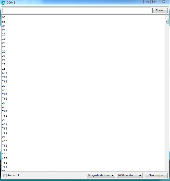

problem with translate the values of voltage sensor ZMPT101B
Regards,
I'm trying to use a voltage sensor ZMPT101B (with an arduino uno) to obtain the voltage values of the network (220 VRMS), but i don't need the RMS values, i need peak to peak values, ergo -311 V to 311 V (the values between that range).
The sensor is the shown in the following image:
But, the problem is that the values given in the monitor serie of my arduino are very variable and because of that i can't make a formula to translate the values of sensor to voltage values.
the code that i'm using is the following:

An this are the values that monitori serie shown:
|465x500
I hope ypu can help me with this problem. Thanks.
Although you didn't exactly specify it I assume you try to measure AC voltage. AC by definition has a voltage level in the form of a sinus wave so depending on the time you take the measurement you'll get any value between -Vmax and +Vmax. If you want to find out that Vmax you have to measure for a while and use the maximal value you got. Correct me if my assumptions were wrong.
pylon: Although you didn't exactly specify it I assume you try to measure AC voltage. AC by definition has a voltage level in the form of a sinus wave so depending on the time you take the measurement you'll get any value between -Vmax and +Vmax. If you want to find out that Vmax you have to measure for a while and use the maximal value you got. Correct me if my assumptions were wrong.
Yes, you're right, that's is what i'm trying to do but if i measure for a while this are the values shown:
|469x500
And those values are very variable.
Yes, you’re right, that’s is what i’m trying to do but if i measure for a while this are the values shown:
No, you don’t do that:
sensmax = max(sensorvalue,600) ;
That line returns in sensmax either sensorvalue or 600 depending on which of the two values is greater. I cannot see any code that gets the maximum value of several measurements. Also I assume that the output posted in your first post was not generated by the code in the same post. At least the number 600 in above line was probably set to 300 for that output.
Yes, as you would expect for a sine wave.

Yes, and that just puts out the measured voltage. Depending on where you hit the sine wave it may show any value. Did you really expect something else? You do know how AC works, do you?
pylon: Yes, and that just puts out the measured voltage. Depending on where you hit the sine wave it may show any value. Did you really expect something else? You do know how AC works, do you?
Yes, i know, but i think you are not unerstandig what i'm trying to say, maybe i'm not expressing my ideas properly (sorry if my english is not ok).
I know that in the AC sine i have a lot of diferent values in the wave because the values are moving from peak to peak. The variability that i'm saiying, if you look closely in the values shown in the second monitor scope seems not to move like a sine wave, one not spect in sine wave that the values stay for a long in one value and then just jump to anoter higher value without passing by the intermediate values.
i have been clear?
Did you check with a scope that the input on the Arduino really gets a sine wave meaning that the "sensor" is delivering what you expect? ZMPT101B seems to be a transformer only. I haven't found a schematic for the rest of the circuit that is on the picture you posted. Please post a schematic of that circuit and how you wired the board to the Arduino.
In the output you print to the serial interface you have no timing component so you don't know the time difference between two consecutive measurements. To analyze the output the timing information is needed. Using above code you get about 200 measurements per second at most and that timing is not very exact because it depends on the serial buffer to be cleared and refilled. So the more or less random numbers could be explained perfectly.

As you say, the delay is very tiny, and one spect that the values move growing and decresing in a wave form with a period of 20 mili second, but instead of that i have a values growing and decrecing in very tiny period mso much less than 20 ms, so i think maybe the Arduino receptors of analogue signal are defective.
what do you say about this?
Something is very wrong here - your scope is not seeing a true representation of the mains voltage , it just looks like noise pickup .
Does that sensor output an AC voltage ? ( it looks just like a transformer with a follower amp ) In which case you can’t just connect it to an Arduino and expect to get a sensible result - it cannot measure the negative voltage . That needs sorting .
Don’t understand why you want peak voltage , when this is readily scaleable from the rms value - if it’s not a sine wave then that sensor may not see harmonics .
Personally I’d look at either offsetting the AC so it’s always positive and either make smooth DC from it or sample it and seek the peaks ( not easy as you will need to sample at a high rate).
It needs a precision rectifier circuit to make DC proportional to the rms AC , that’s how I would do it

There is something i did'nt unerstood... why i have to see the signal of the analog input in DC?... the input to the sensor is AC, and i understand that this sensor is just a transformer and a regulator, so in the analog outpur i will have an AC signal betwen 0 to 5 V. or i am wrong?
I am sorry for the resolution, but I believe this is the circuit of the unit.
With NO AC input, it outputs 2.5Vdc or half Vcc.
With AC connected, it outputs an AC waveform centered around 2.5Vdc.
The magnitude of the AC waveform is adjusted by the potentiometer.
You need to have the scope in DC because that is the only way you will see AC and the DC offset.
When you have the scope set to AC, any DC offset or component is removed from the displayed signal.
You should be seeing on the scope a sinewave that is ALL positive above gnd.
Tom.. :slight_smile:
Ok the AC is offset so you can connect to an analog port .
That waveform is still odd - surely it should be a sine wave? There is an input resistor to set on this circuit - is that correct ? Looks like the circuit is clipping or the transformer saturating , suggesting wrong input resistor, or the power supply is not right.
The parameter to the delay function is an integer. The simply calls delay(0);
     delay (0.000001);
You still have a baud rate of 9600, you cannot see enough values at that baud rate.
hammy: Ok the AC is offset so you can connect to an analog port .
It needs to be adjusted, pot is set to high and that is output flat topping. Tom.. :)

Never trust to circuit's from internet. This on have sad mistake which makes impossible to use it with microcontroller. Both secondary coil ends of transformer are going to opamp, but if You using single polarity to power opamp, You will get only half of signal and it will be distorted, since transformer output still AC and goes to negative voltage. Solution is to connect transformer end to digital ground, while opamp will use vcc/2 offset as reference to have DC sinewave at output.
Here is the results of simulation:
