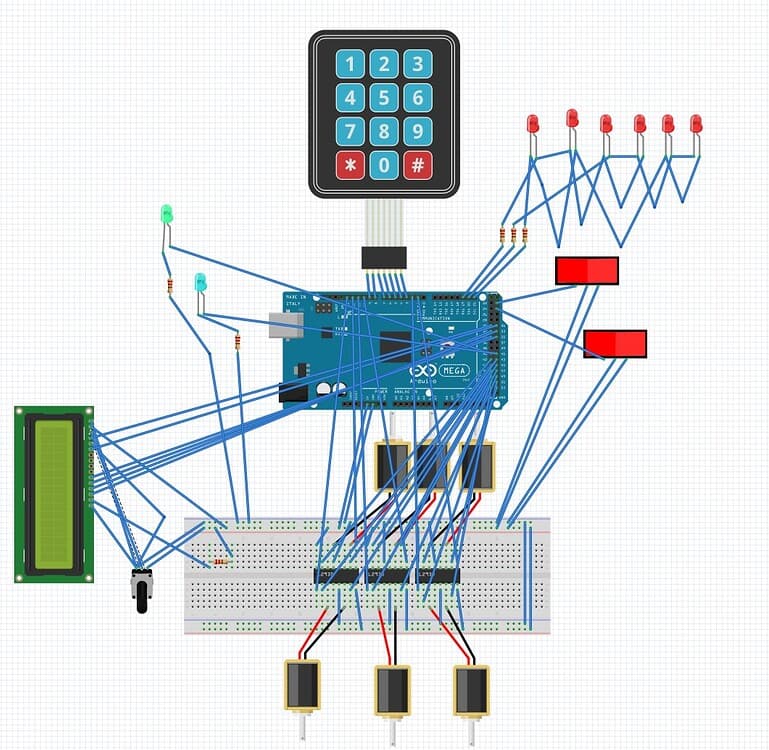

Hi all, I have an issue with my "while" statement on line 146.
The idea is that I have a keypad, when I push a button, I can enter a code, and when the code is right, I have some gear motor turning. While these are turning, I have 12 LEDs red turning to show that the motor is still not finished. When motors are finished, the red lights would turn off (not yet in the code), and some green one would light on.
Problem is that the red turning light (working fine if alone), part of ledloop() stop as soon as the motor is starting Closepiston().
I don't get how to write it so that they keep on turning until the motor are finished.
I have added one var1, and though that, i could change the variable at the end of the Closepiston() going back to the loop and with the changed value, the ledloop() would then stop. But still, same, the ledloop() actually stop as soon as Closepiston() starts ...
Here my code:
